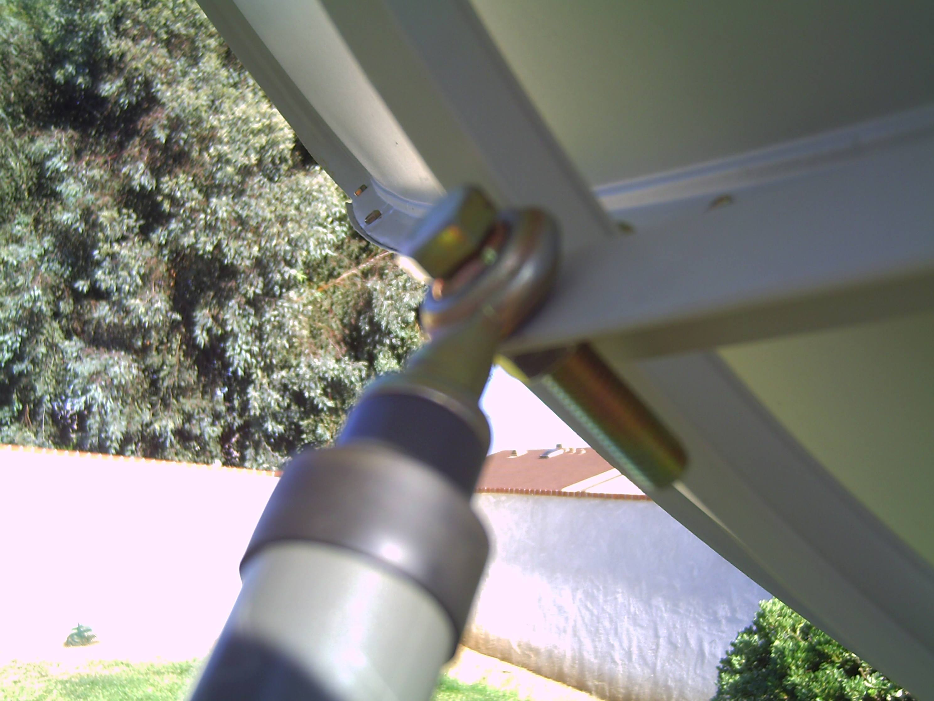

Look at the rod end. Mine is installed on the same 6' WSI and the rod end of the ball screw was larger than the room between the bolt mounting for the main piece of angle steel that goes across the mount. The rod end would rub pretty tight against the bolt near the connection point. I probably could have added spacers to lower the rod end on the bolt to provide clearance but didn't have any spacers handy. I ended up grinding the outer portion of the rod end about .100" smaller. It has just enough clearance not to rub and no more noise or slowing of the acutator.

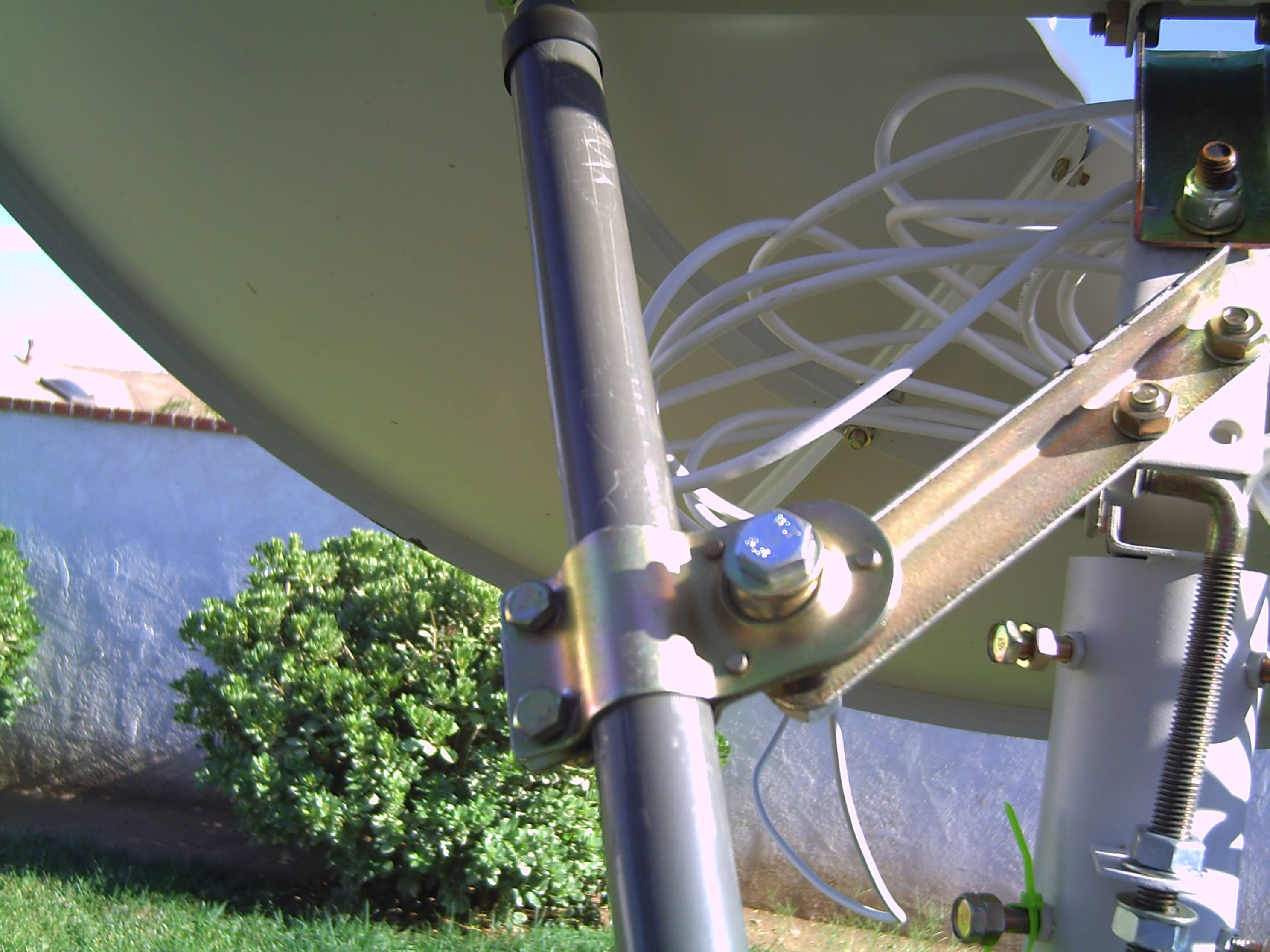

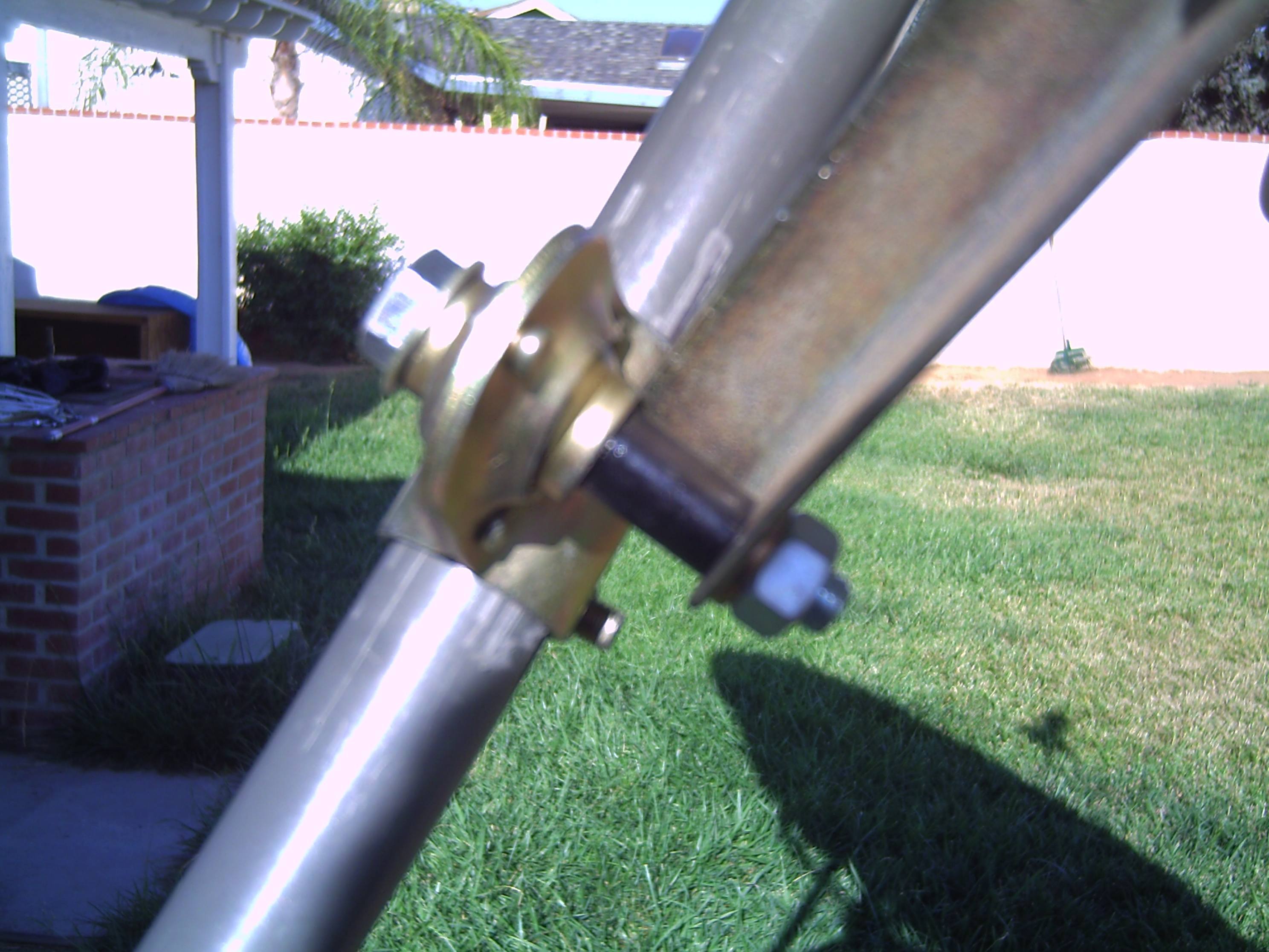

I thank you for your suggestions, here are some pictures of my setup.

It's not Binding, it's just the nature of that Flimsy Dish. I had one and tried a few things to try and isolate the Actuator from the Dish to reduce the noise . Didn't get it to quiet down much.
Dish has been put in the garage..........R.I.P.
thank you Dougruss
Well, I will play with it, I do get some good signal Q with it, the noise doesn't bother me, so fat I hit my true south 116.8 satmex5 and 113.0 satmex6, I install my new lnbf C2 and get most of the channels for these sats and a few more.
