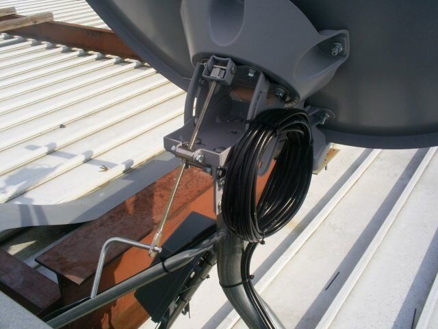

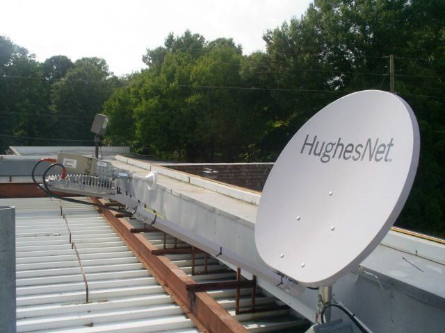

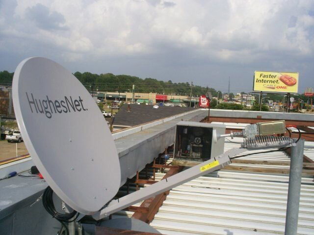

Installed this today. First I have seen.

also, looks like that on a canopy, enterprise perhaps? just out of curiosity, what are the first three letters of the sid?
looks like maybe on top of a restaurant... Sonic Drive In, or something of the like... Just guessing

This was a Small & Medium Enterprise job. It only used a 9000 modem with a 2 watt radio. It was on a independent gas station that was using it to hook into there Ruby just like BP. Not sure if you have done any SME jobs but thats what this was they just updated these to the 9000's. I also done another the next day just like this but in a hunting lodge.
