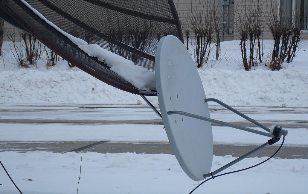

Yes an Openbox s9. The STRANGE thing is, it only was observed on 97 on the motored 30 inch. 3 other satellites with the same dish worked H and V. Back to 97 and only 2 Vertical TP's registered Q while the H TP's were 'normal' Q. Checked cables and fittings, clean and shiny, and 'while at it' swapped the LNBF. No change. Went back to the other 3 satellites and noted H and V TP Quality, not just missing channels, all fine. Started typing post while moving the dish back to 97 and flipped thru some channels and that's the Hey wait! moment. :gremlins?

Dead "ON" I checked. Centered up the BUD then tweaked the 30 inch. (it's mounted on the BUD)

And as expected, as the rain moved out and the mist is abating, seems they are all returning. A bit weak, H and V, but need the thick clouds to leave also. Might have to think about putting the 1.0 meter on the bud.???? :eek It's a lot heavier.
