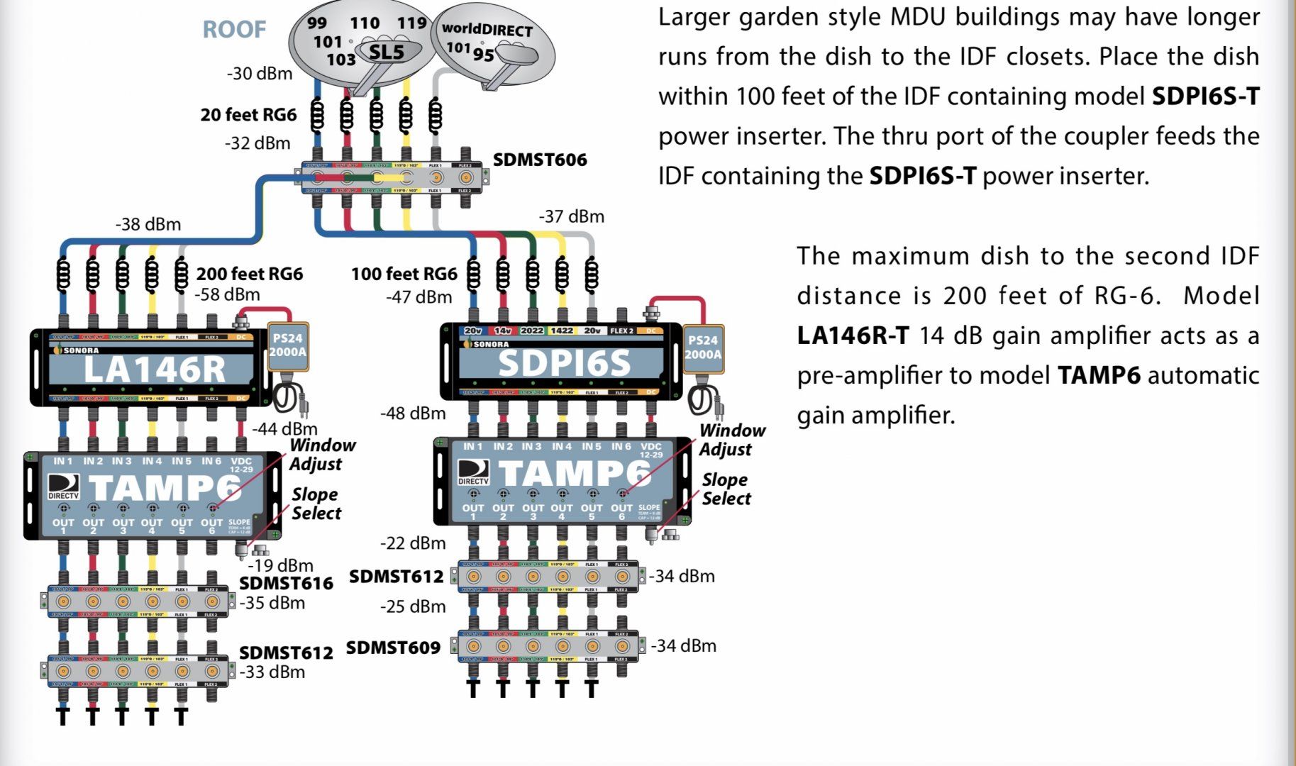

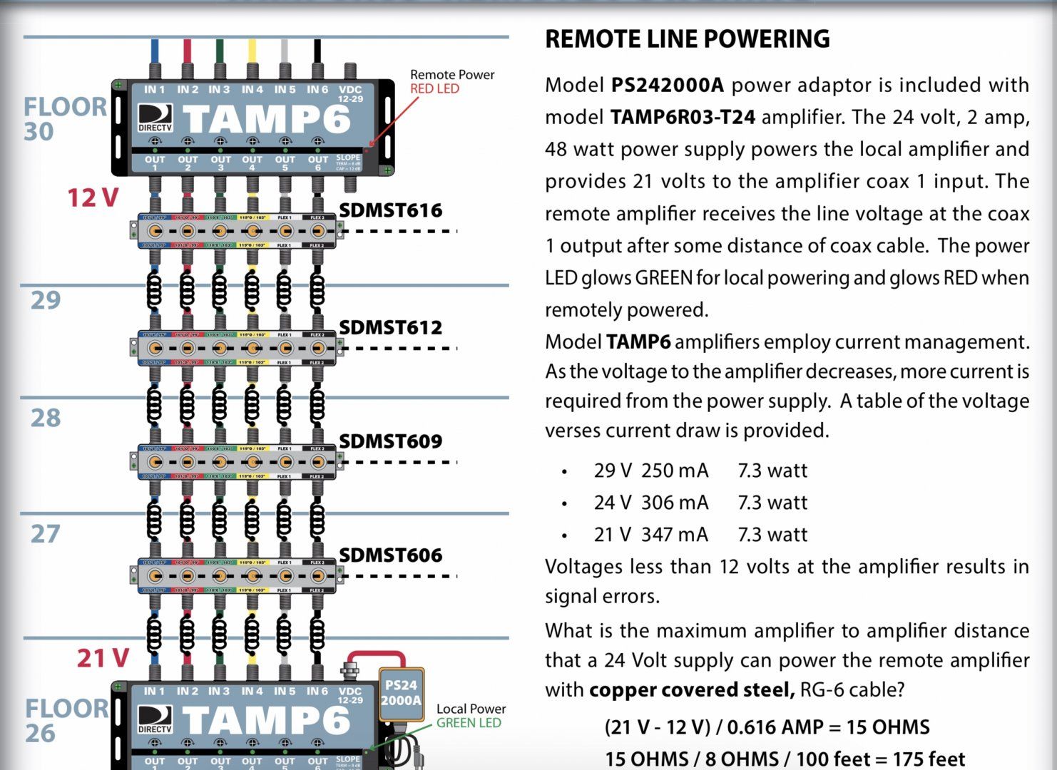

Thoughts? I would not need the left side of this tree, just the right. Second dish at this time. I can't find the TAMP6RO3-24, what are good alternatives? Thanks!

I'm the contractor that quotes this type of stuff all day long.
Slimline dish on the roof, 6 lines to a polarity locker, and 6 lines to each floor with a tap. SWM amp every 3 floors.

I've also done a lot of commercial installs, including 11 floors of the old DirecTV corporate headquarters, engineering buildings and several broadcast centers. If I were in your shoes, and thinking of the future, I would work with the building owner to install a system that will expand and potentially feed anyone in the building and you would be the first customer. You could probably sell the owners on a plan where they pay for the system and possibly charge anyone a small connection fee to recover their cost and of course you would get a free connection for the idea and help in designing it.
The benefit for the building owner would be one single dish on the roof to feed everyone and a clean install, avoiding a future roof bustling with sloppy dish installs and cables run over the side of the building flopping in the breeze. I would consider a single reverse band dish with launch amps in the top floor closet and appropriate taps on each floor to feed an appropriate number of SWM modules on each floor. I would also use RG-11 for the main trunk lines down seven floors and wherever else practical.

I spoke with the OP tonight. Besides cable and doing bare bones to get it running, about $400.
I think we had the following
Dish $100
Polarity locker $60
(2) swm amps $236
(2) taps initially, adding more as customers get Directv $60
(1) DSWM30 initially, adding more as customers get directv $45
(4) 29 bolts $28
