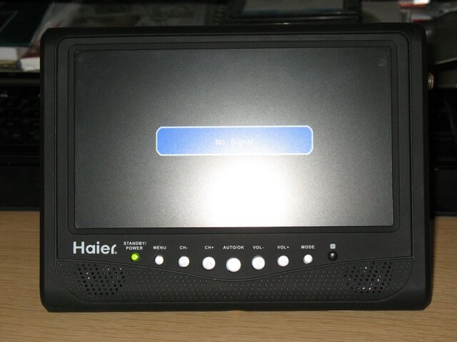

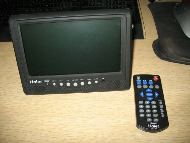

I've got a Haier 7" TV and the screen resolution is poor. Hard to see S&Q meters. But better than some alternatives :) This only has a Composite input
I have the same Haier 7" tv. Bought it refurbished @ newegg. It is difficult to see w/o a shade in the open.
I have that very same little TV. It does help. It's waaaay better than not having one. I just put on my strong reading glasses and it's all good..
What I like about it is that I can put it on an Openbox to tune S2 stuff or if I'm just looking for regular non S2 things I can use my little meter and put the Haier TV on it because it's screen is about like an old school cell phone screen, too small to be of use.
Despite the potential screen area that could be used, it uses a tiny bit with a large border so the info is very tiny. I just plug the Haier into it and then I can actually read the thing..
As others mentioned, it's very hard to see it in the daytime. But then again, all LCD screens are almost impossible to see in the day time.

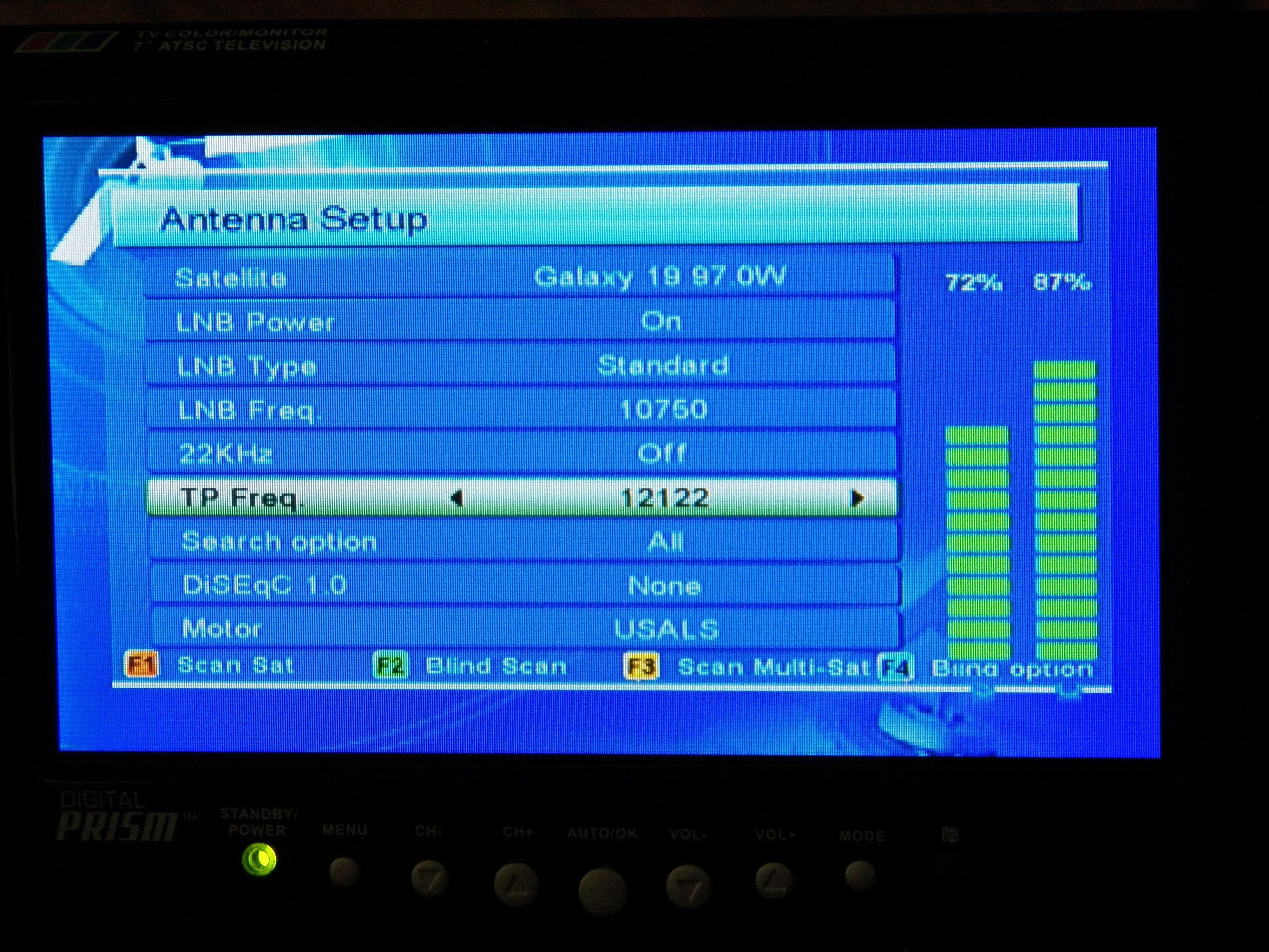

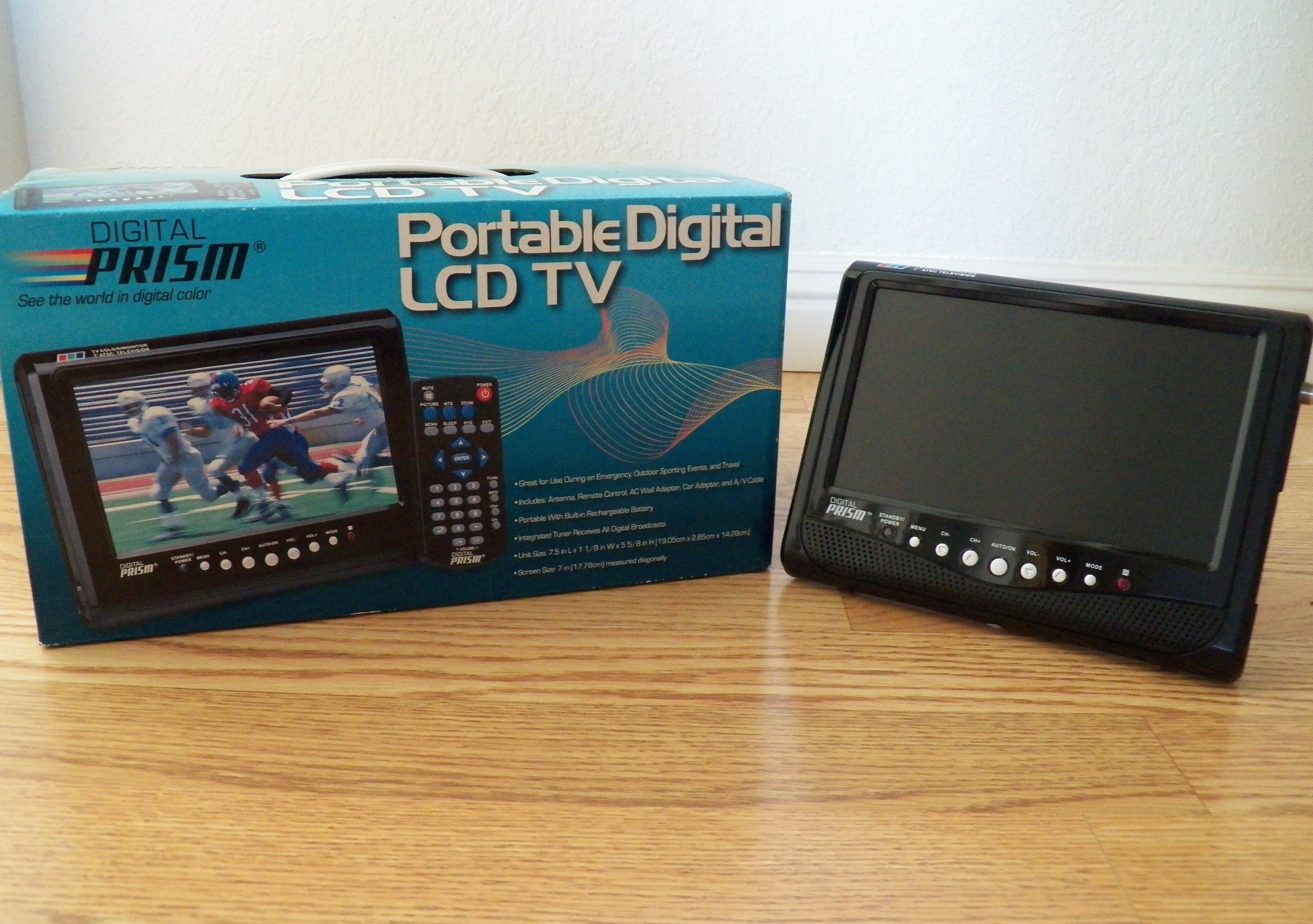

I bought a 7" Digital Prism LCD for $19.99+tax on clearance from CVS pharmacy a couple of months ago. The tv produces great video, but the antenna that comes with it was useless and changing channels on the clear cable QAM side was a bit slow and buggy. Still, the small thing defintiely beats lugging an old, heavy 10" CRT to the backyard in addition to the sat receiver.
Finally had time to go out @ 5am with the LCD and sat receiver doing some tweaking on my 1.2m dish and was able to squeeze a few more signal/quality points. Also finally figured out since setting up the dish a couple years ago, it actually needed a slight adjustment with how it was seated on the motor tube. :doh: USALS is now much closer to my actual long./lat.
