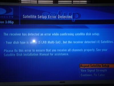

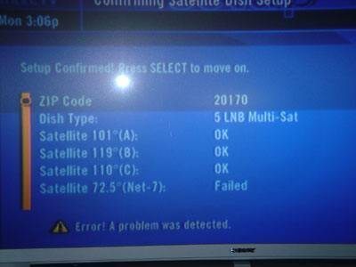

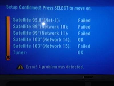

My installation didn't go well at all. The installer had never seen the AT9, therefore he didn't know how to install it. I showed him the videos, and I don't think he followed them at all. He had an old meter with him, but he said he couldn't use it to install this new dish, so he just kept on coming back to the living room to check the signal. He spent close to 4 hrs at my house and he still couldn't get all Satellites up. However my HD channels (ESPN, Discover work just fine). I am going to have to re-schedule someone to come back to fix the alignment :( Here are some pictures of my errors.

GUYS!, Heres one of the solutions to the problem many of you are having. During the sat settup screen, it ask you which dish you have, check 5 LNB, Next it will ask if you have sats 72.5 or 95 installed, "Here one solution many are having" if you do not have a 2nd or 3rd dish and receive either of those sats, make "sure" that these say "NOT INSTALLED" and continue. If you select "Installed" but do not have them, you will receive an error and the installation will fail. It also ask if you have a 6/8 multi-switch or 4/4 connection. If you don't have a 6/8 multiswitch nor the above additional sats (72.5 and 95) press and select 4/4 or vice versa if you do have them. Note also that when you complete the settup, your H20 will try to verify your selections, a few sats will still show failed, for example, sat 99 Network 10 & 11 will fail as it has yet to broadcast. Sat 102.8 (103) will also show up twice as Network 14 and 15, Network 14 will pass and the other will fail. You will see an error message after these steps, this is normal, press continue and finish the settup process (including those who have OTA settup). This should help most of you who cannot seem to get the settup complete. Some installer are still having trouble with this process!
victor20170, if you have sat 72.5 check to make sure the installer used multi-swich and connected the 72.5 sat to it.
To echo reply by Smthkd .
The setup errors you got are NORMAL.
If Sat 103 Network 14 is OK then you're in business for D* LIL HD feeds!

Thanks for the tip about the 2 Satellites. The installer did choose I had them both even though I only had the AT9 on my roof. I think he did it because it was the only way to bypass the multi switch screen, in my case I do not have a multi switch. I'll go through the installation menu and remove the Satellites. I guess the installer did do a good job after all. I am getting an 86 signal on my H20, which seems to be pretty good if you compare it with what other people are getting.
Victor
