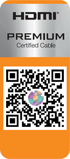

I know that more expensive HDMI cables are really no better than the ones you can buy at Monoprice. However, the Monoprice cables I have are at least 6-7 years old. Could it be that my old cables are not capable of transmitting 4K?

While the old cables may or may not work, I do recommend you buy at least one Certified Premium High Speed HDMI Cable for experiments. The one with the hologram sticker.
