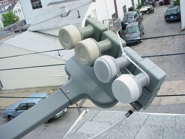

Well, Mr Red Green would be proud of my new setup... I strapped on a 4th LNB onto my Phase 2, with Duct Tape ;)
I couldnt find any large hose clamps or my bag of zip ties.. I only found the one, which is holding the feedhorns together (with a chunk of duct tape between them to ensure "proper" spacing), and then about 6 feet of tape around the lnbs.. hah

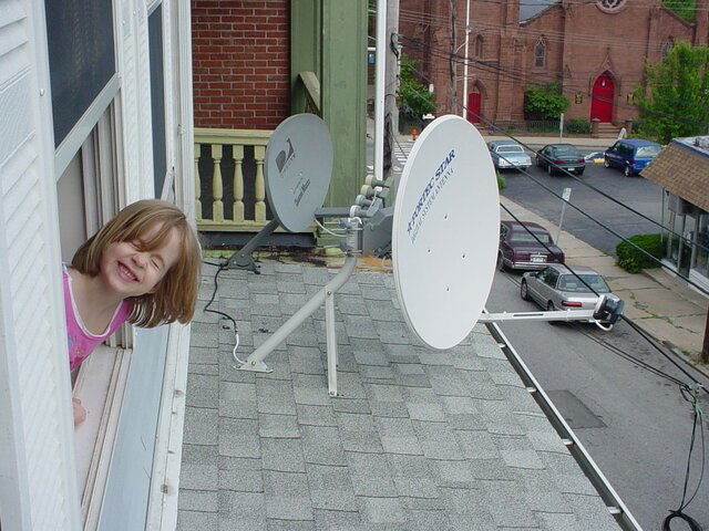

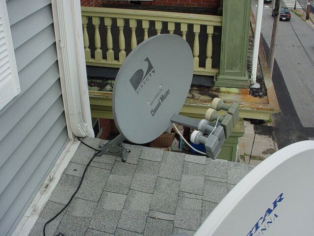

Cant go wrong with Duct Tape!.. Got some new photos this morning ;)
Be warned, these are really big pictures.. and of course, my daughter was hamming it up, and really wanted to get in some of the pictures ;)
On the default TP (12224 V 20000) on my reciever, I get 88-90% signal, and 99% quality on all three locations (110, 119, and 91).. Not bad for 20 minutes, and some duct tape!
I went out a few minutes ago, and tweaked the 91 location a bit to get perfect signal, it was about half a centimeter too low when I slapped it on, but all in all, it was aligned very well (was getting 70% before messing with it)

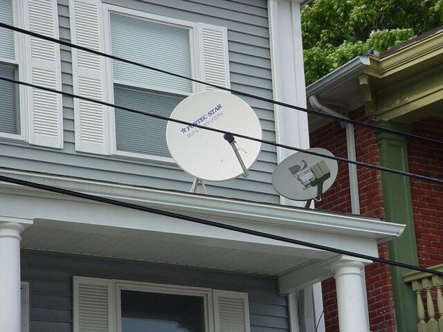

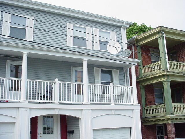

new photos.. exterior shots. These are from the other side of the street.. the other dishes are above the roofline, and cannot be seen from the ground at all (except the very edge of the 61.5 dish, since it points much further east then anything else)
