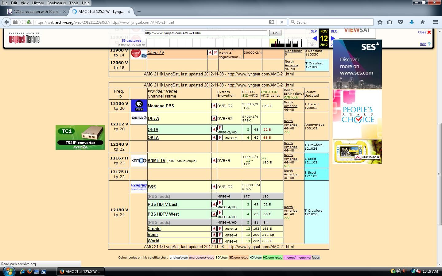

looking at the "way back machine" when I last had FTA they were all S2

I looked it up and at the beginning of 2012 the PBS stuff was still DVB...I thought they were S2 by then
edit: damn it didnt change to S2 until August....but the "subs" were still DVB at the time
Looking at those charts its crazy to see at one time PBS had THREE different muxes going
12060 with the feeds and the subs (world, create)
12140 with the HD feeds in DVB
12180 with the HD feeds in DVB-S2
But its not as hard as looking back when Equity was around and "good" with all their options out there :)
Alot of us had fixed dishes at 123W JUST for those stations
