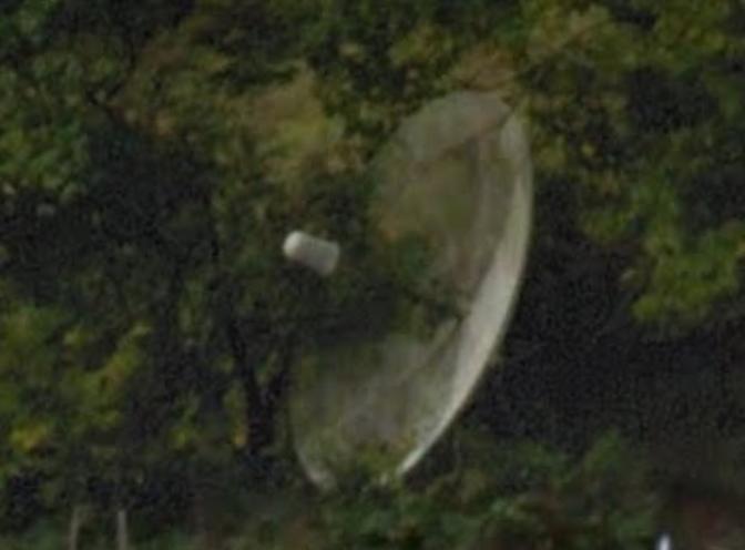

Did you try to walk around in google street view and try to get a look at it?
If its not to far from the road.
Reactions: KE4EST
This is the best I could get from Street View.It is too far away and too obscured by overgrowth to make out much detail.(Actually,it is even more overgrown now than in this photo)

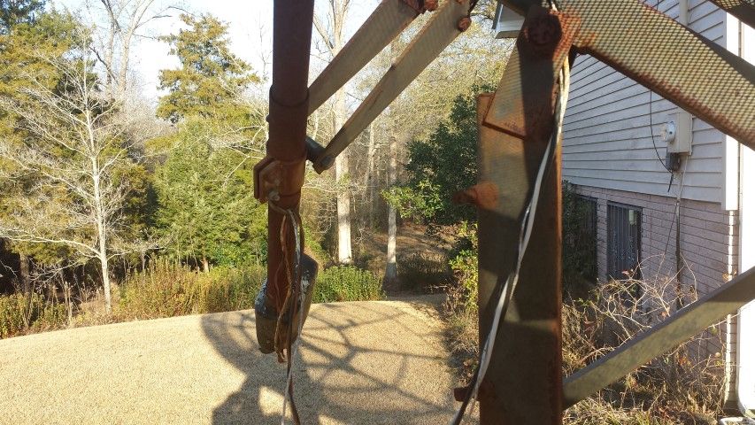

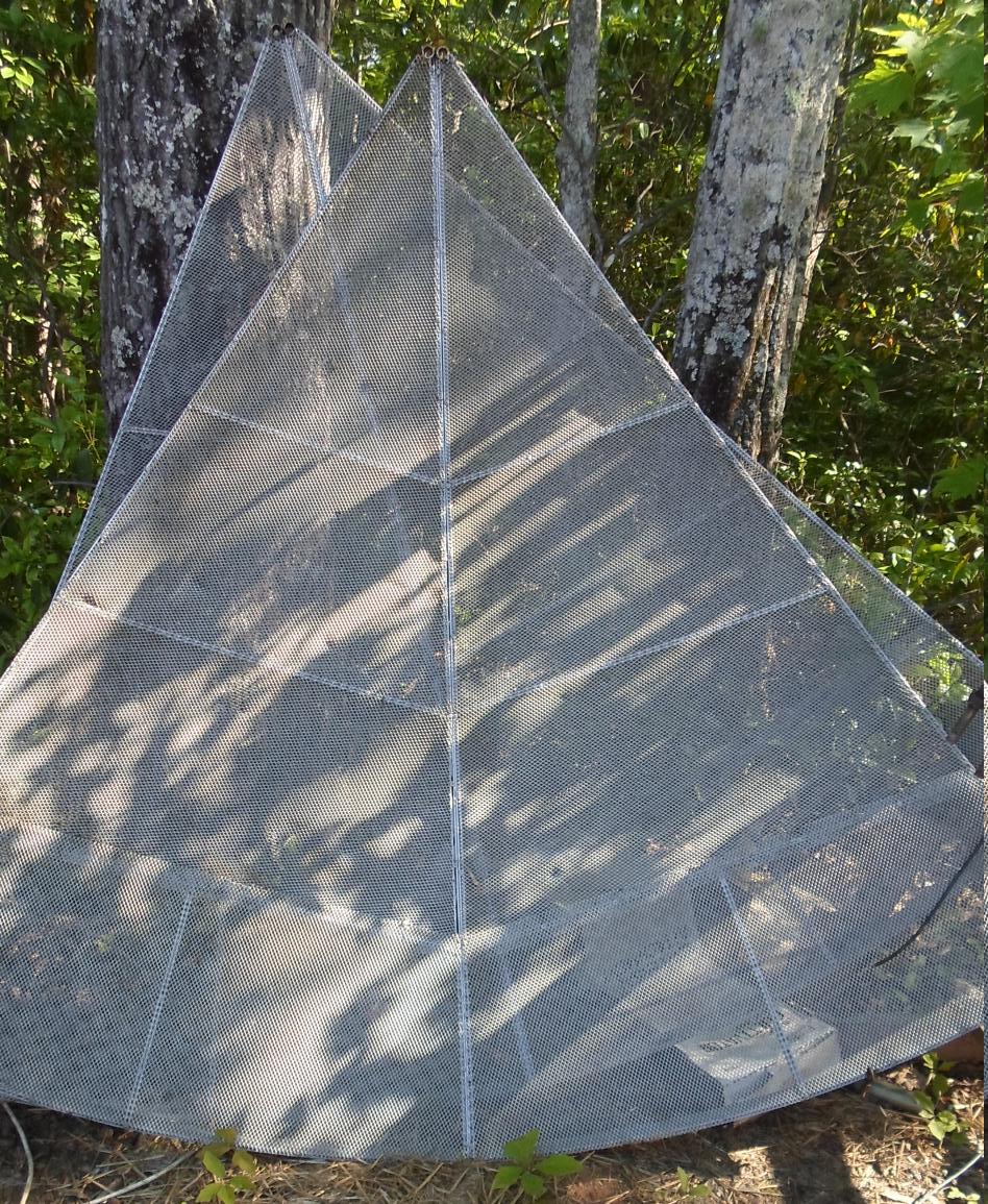

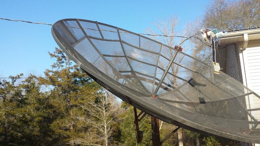

I believe I finally found a similar dish by Googling "Star 12 foot dish".Joe, a mod at Rick's site posted the following pics in their forum :
First,notice the large mount ring.
Second,the long triangle shaped mesh panels with the horizontal additions on the outside.Looks like the outer band might be an add-on.I believe the support ring closest to the outer edge is doubled on mine.
Third,the super long pivot bar.
Fourth,the long,heavy duty inclination bolt/turnbuckle at the bottom.
My dish looked all metal colored ... I didn't notice any lingering black paint.But I could be wrong.If any thing.my mounting system is even heavier duty than the one in these photos.
We'll see how well my memory compares to the actual dish when I go get it.

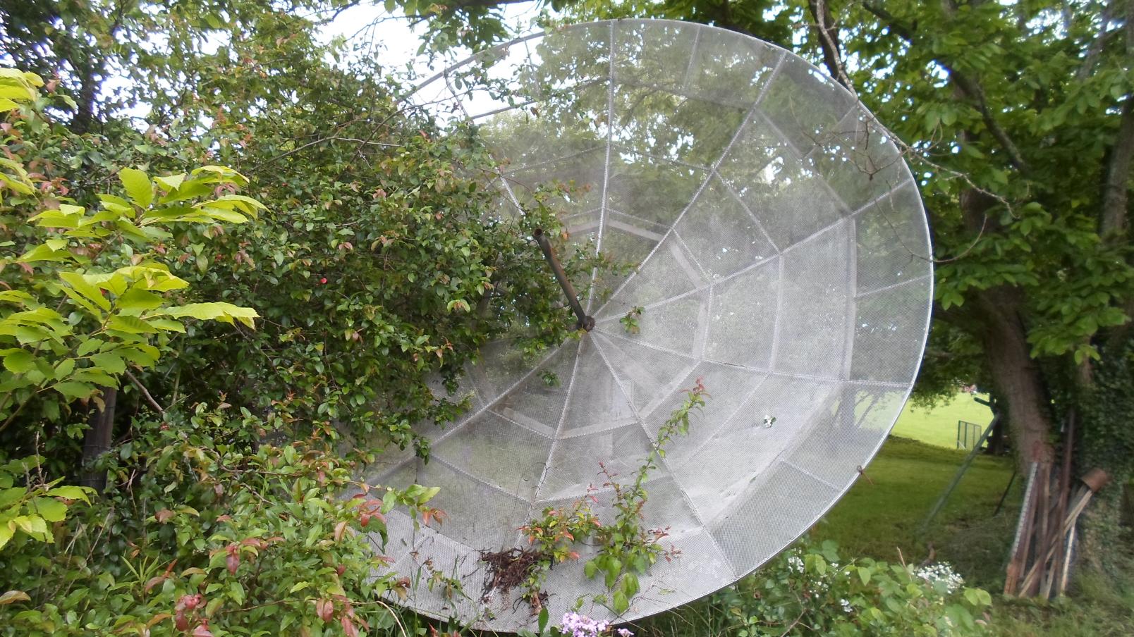

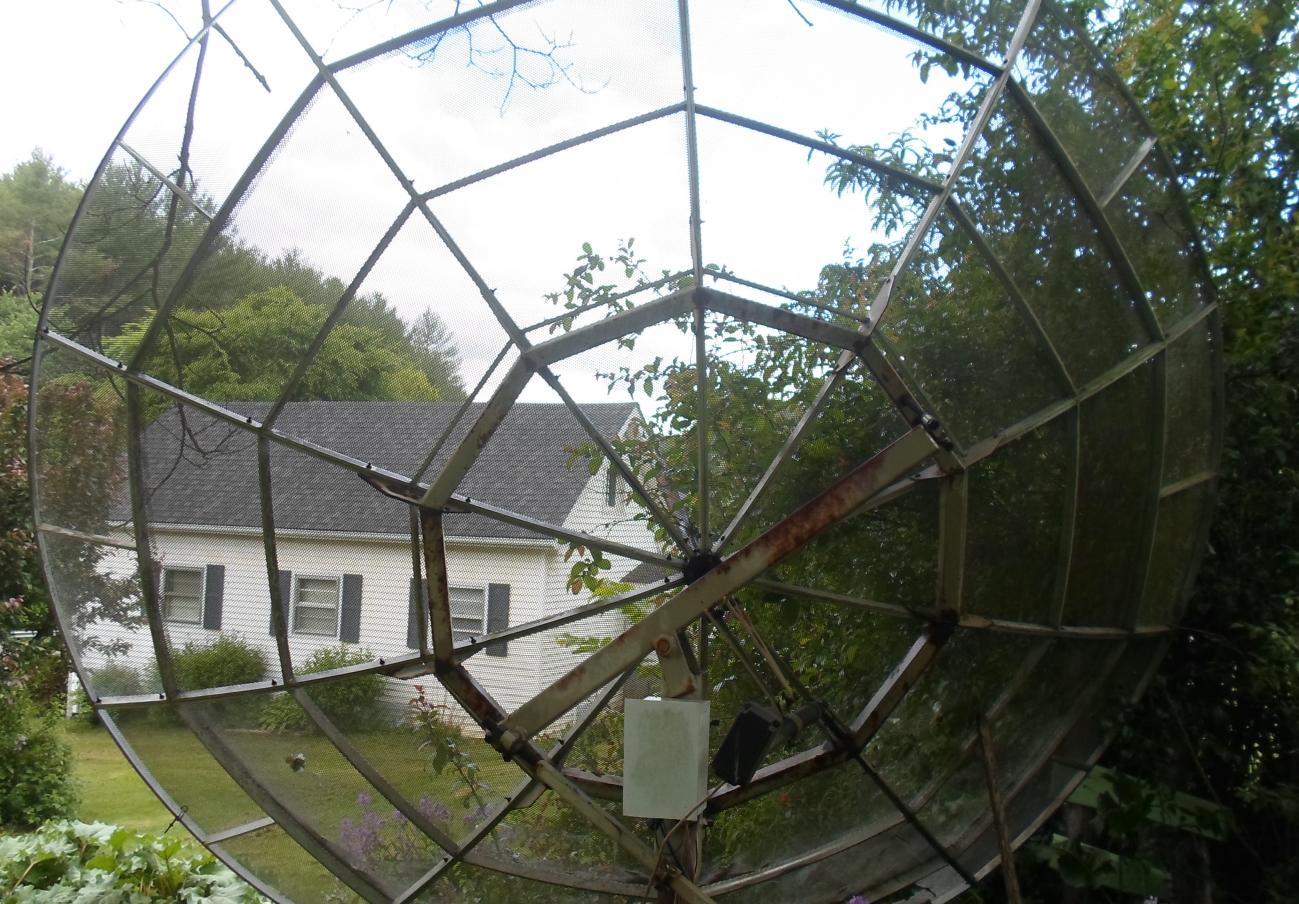

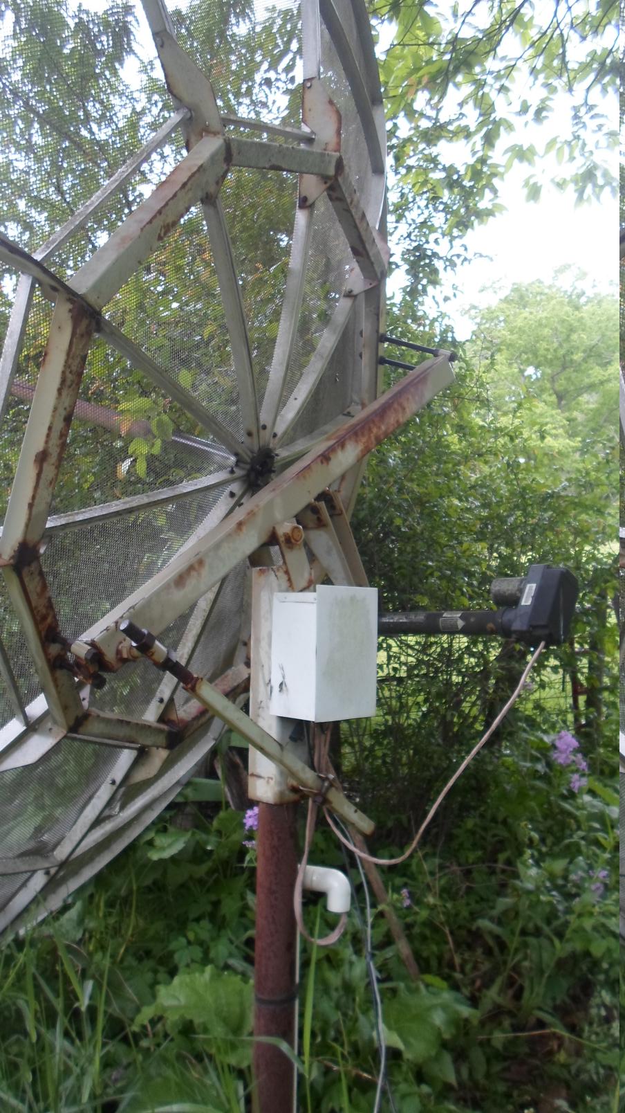

Went and paid for the dish today.PB Blasted the crap out of it.Removed part of the buttonhook and lnb...in case of wasps or snakes inside.And mashed down and removed some of the overgrowth...including some Poison Oak vines.
I hope to haul it home tomorrow. Took some photos for you folks to enjoy as well. ;)
Notice how heavy duty this mount is...might strain my truck to haul it home.lol. The nose cone was completely full of old birds nests,but no wasps or snakes to be seen.The mesh is going to need quite a bit of straightening but intact.Mesh IS pop riveted on.I'm a bit concerned about how some of the mesh panels overlap.Wonder how much those overlaps will effect the reception? One photo shows how large the mesh holes are.
Back side of dish is white,not silver as I first thought.Easier to see with the sun out and vines removed.Aluminium mesh was probably white when new.I'll plan to paint it all black.

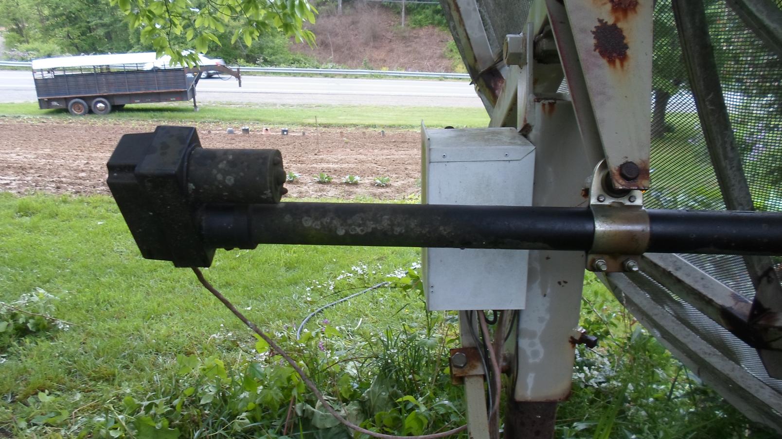

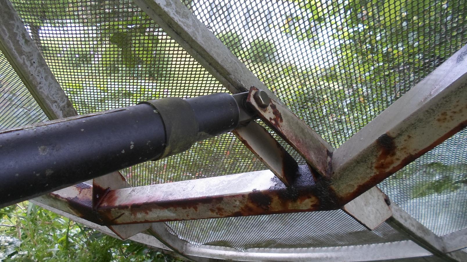

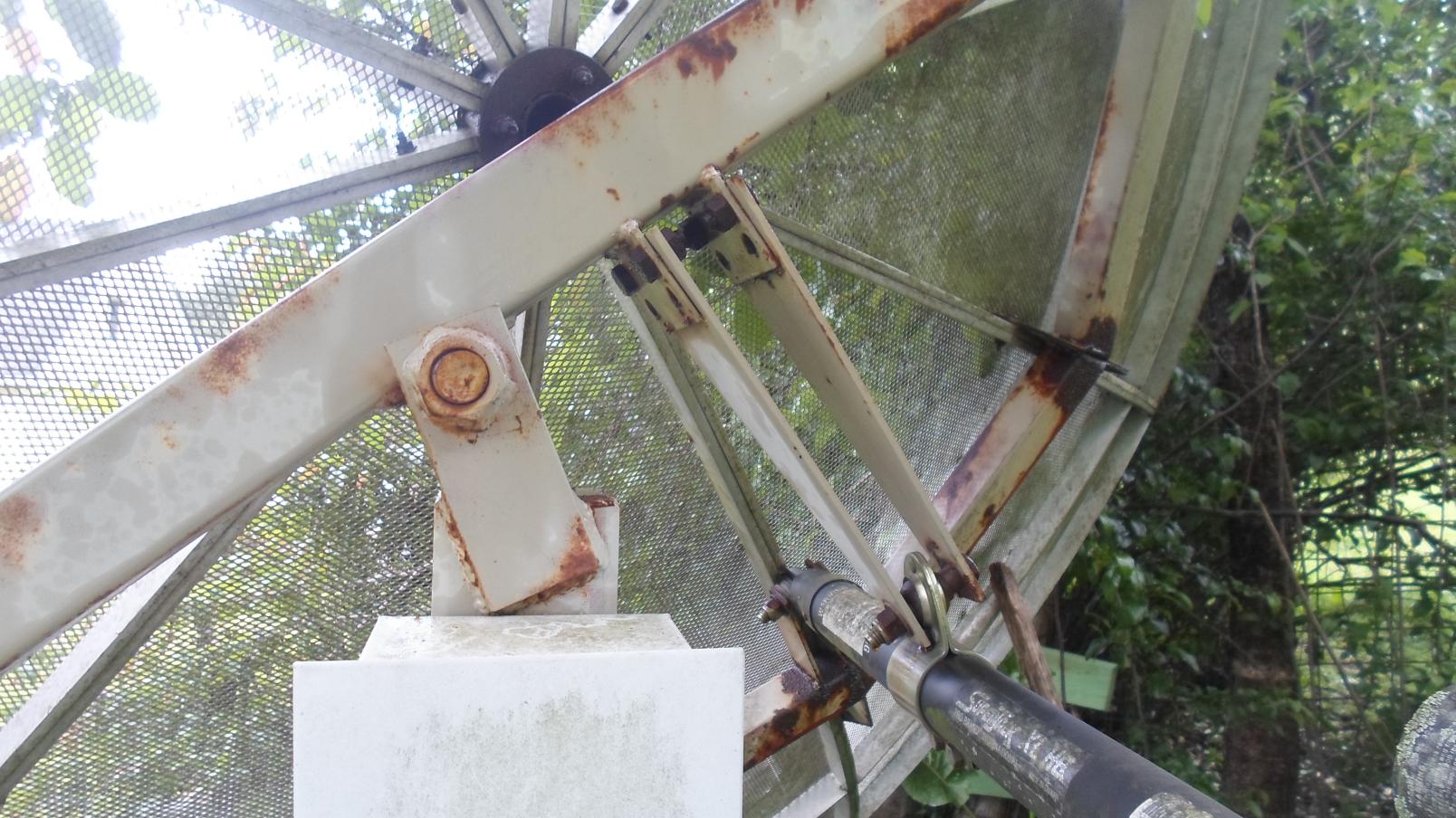

Actuator.jpg Actuator_Mount_FT.jpg Actuator_Mounts.jpg Notice how clean the actuator clamps are.Was slightly used previously...hope it works! SuperJack...forgot to measure it.

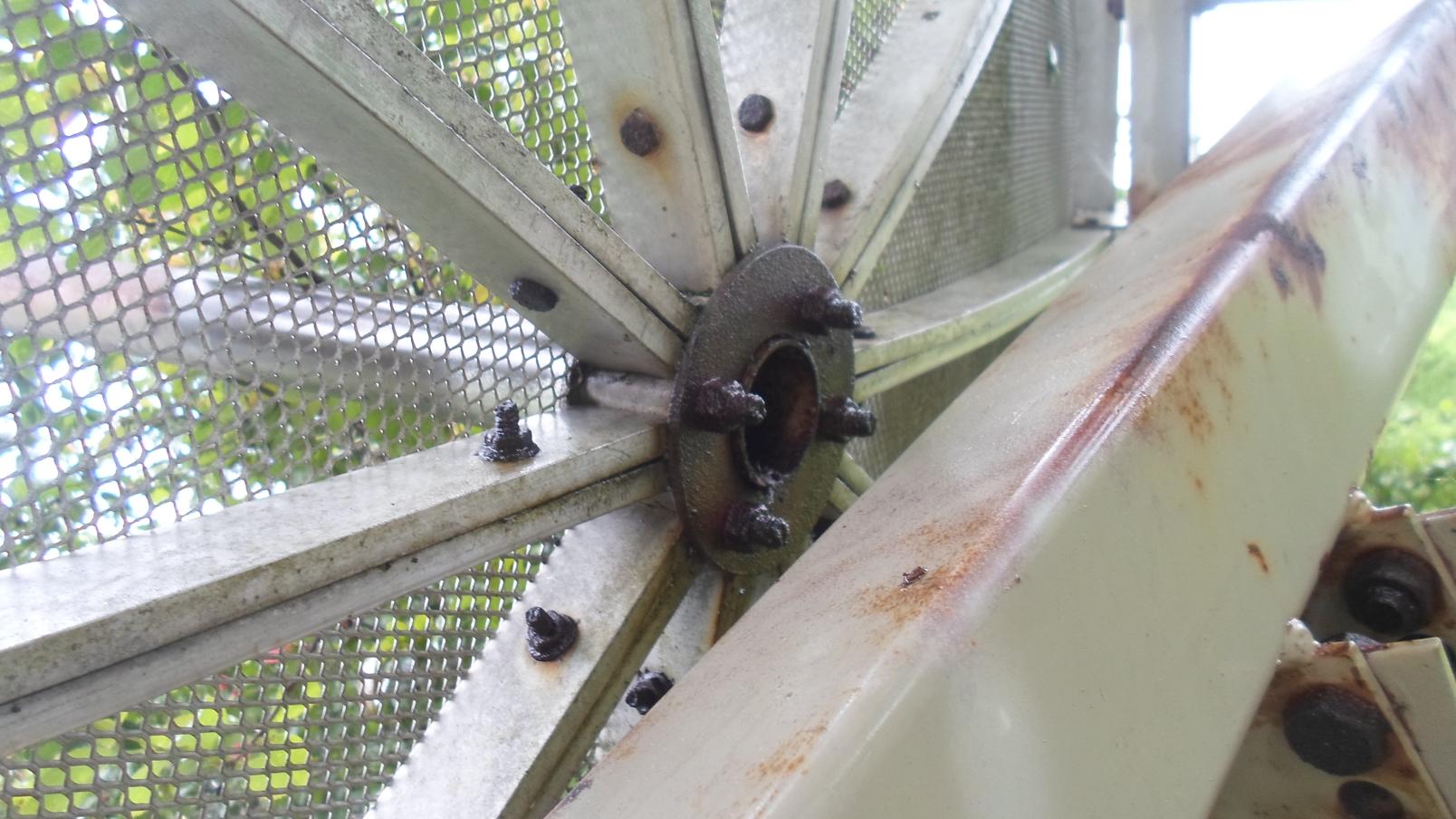

Center_Support.jpg Center support plate is small,maybe a larger one would be better?

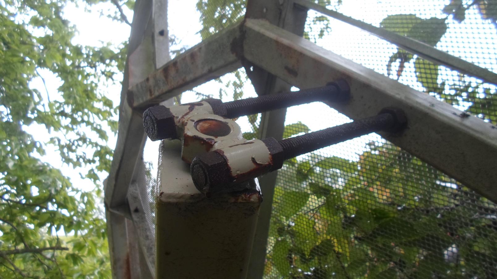

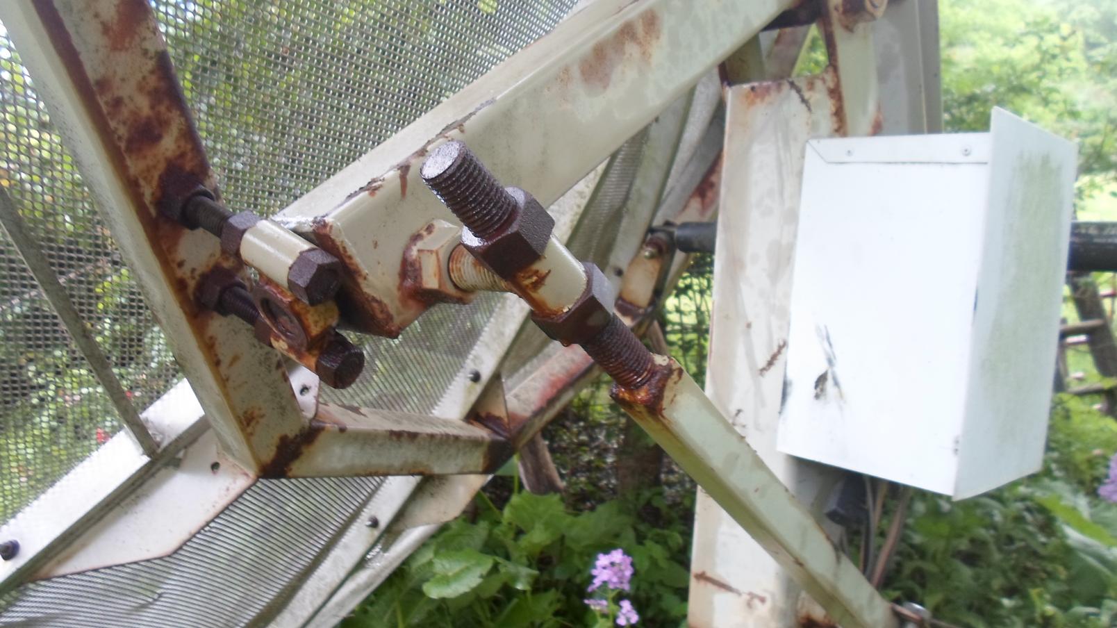

Declination_Upper.jpg Upper Declination bolts.HUGE!

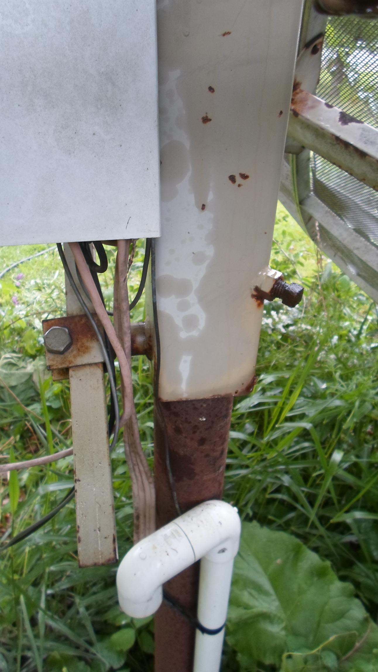

Inclination_Lower_Dec.jpg Lower Declination bolts and Inclination turn-buckle.

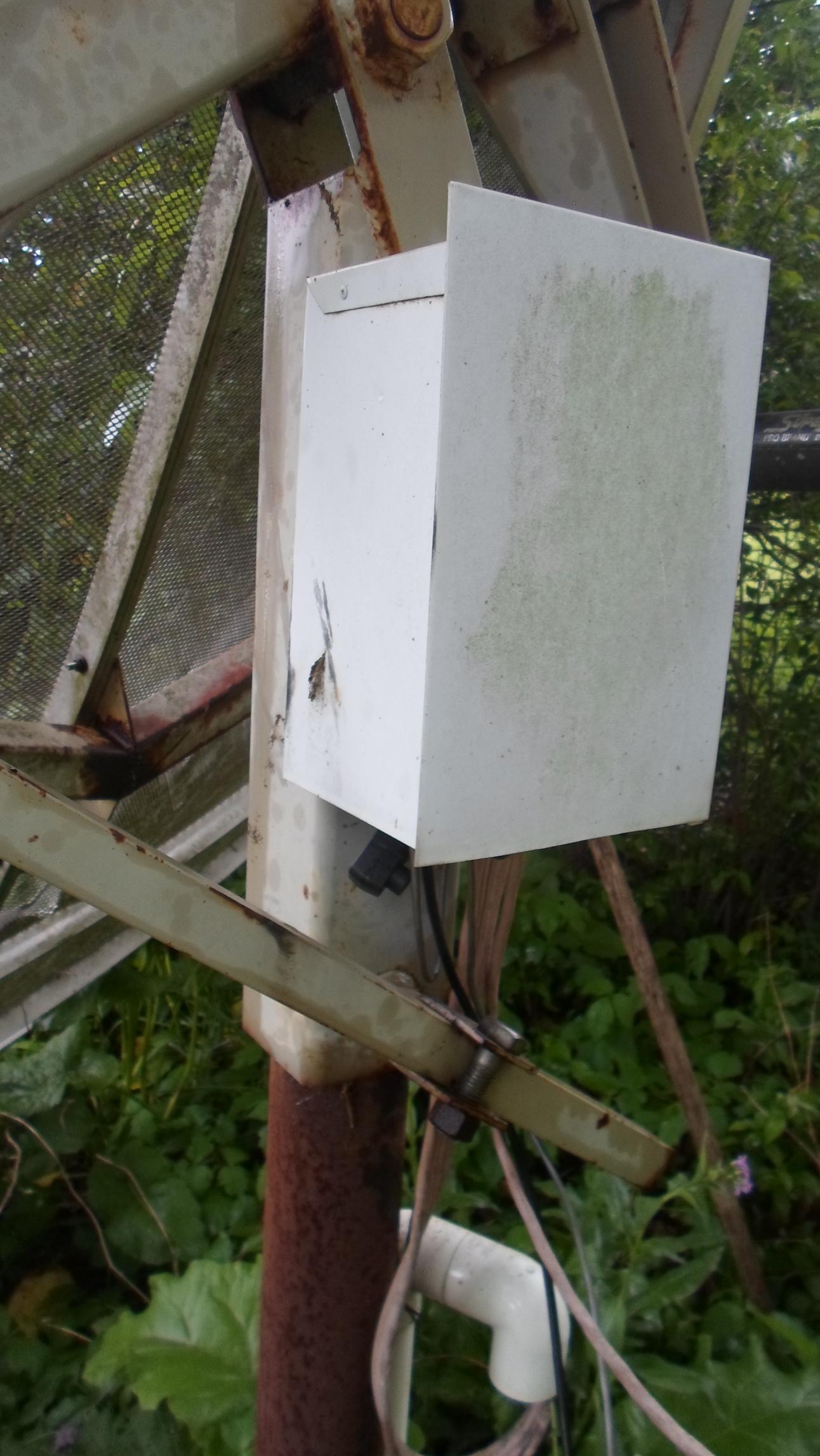

Inclination_Box.jpgInclination lower end and junction box.

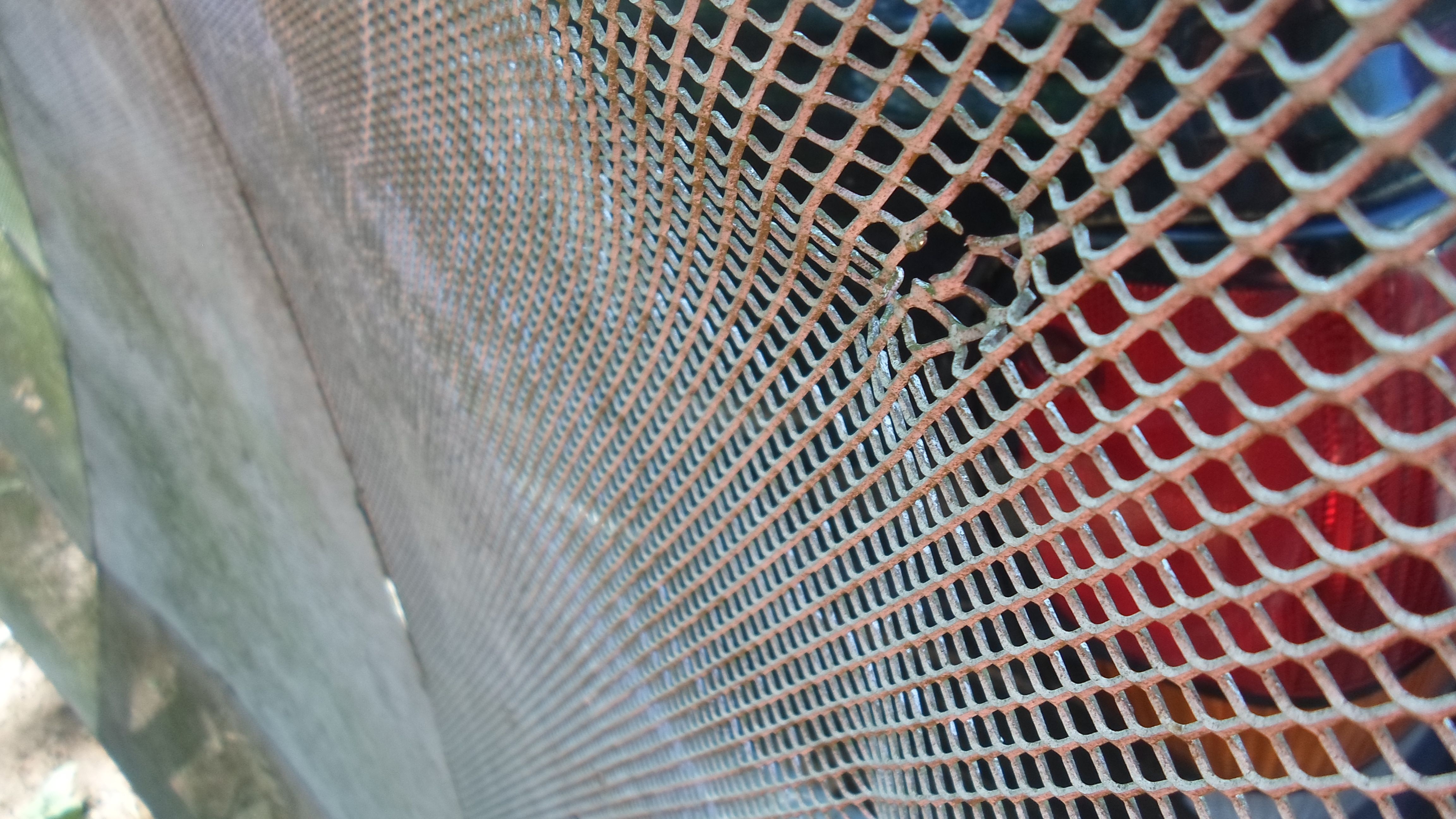

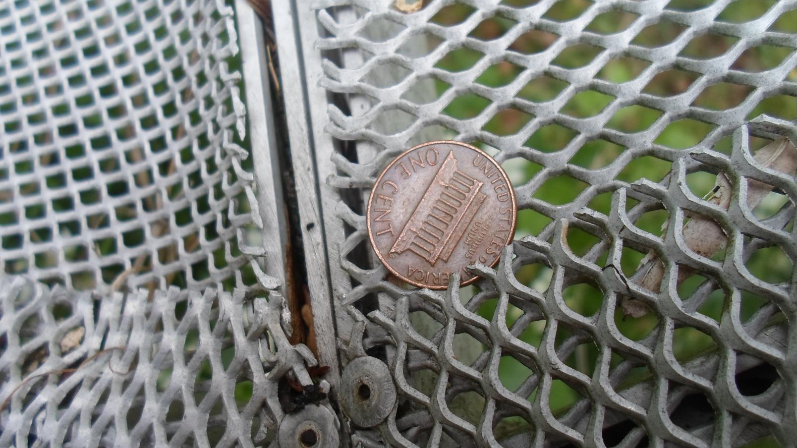

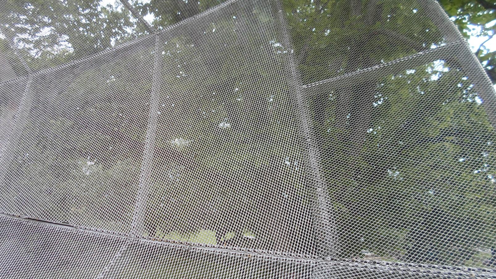

Mesh.jpg Mesh_Panel.jpg < Mesh close-ups.Penny for scale.

Good find! Nice condition for the age. I wouldn't worry about modifying the design. It looks well built for areas out of the path of a hurricane. Clean it up and enjoy C-band. Agree, the buttonhook design will sure simplify FD setting!
Mesh overlap will not be an issue at 3.7-4.2Ghz and was very common in many dish models during the early 80's. Take a few pairs of gloves. The mesh edges will eat gloves like bonbons! Hope you are up to date on your tetanus shot! :eeek
The design of the dish is a series of semi flat panels and not forming a true parabola. The design will be less efficient than a formed / shaped surface, exhibit a higher noise level with slightly increased sidelobes. I am sure that C-band performance will be fine, but KU will likely not be very good. The dish was probably distributed long before KU reception was common.

A formed perforated reflector in good condition would have better surface accuracy and efficiency regardless of the diameter. Unknown how this 12' dish would compare against the 10' perf. The increased size might provide a better mainlobe and the flattened panels increase noise, resulting in a similar/better/worse Signal to Noise ratio. Side by side comparison will be your defining test.
If it were me, I would try to obtain a temporary installation permit from the WIC *(Wife In Charge) and test before performance putting to much labor and materials into the project. Too bad it couldn't be hauled intact to your home without requiring disassembly/reassembly!

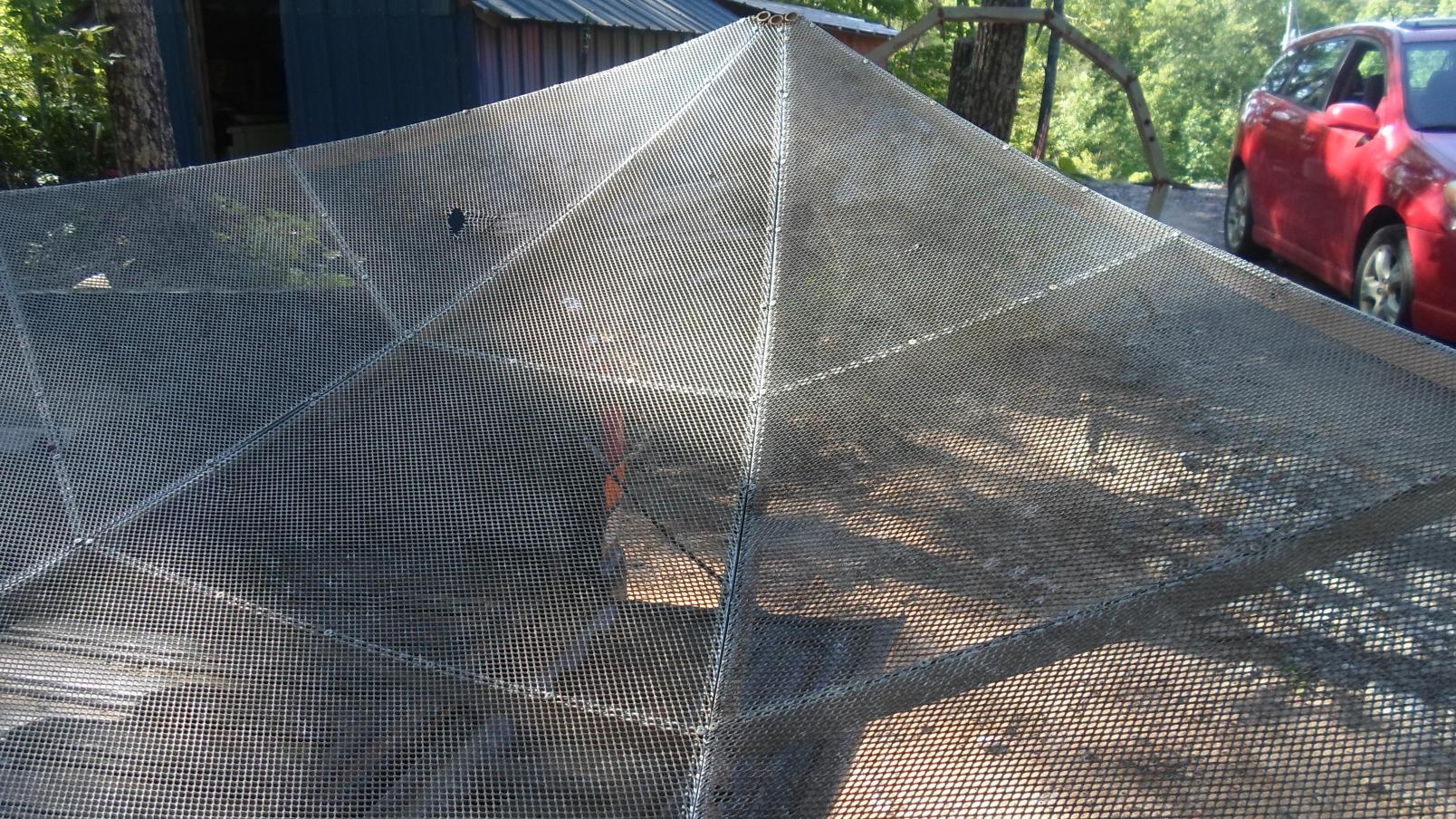

Update: Wife and I got the dish home today.Took about 3 and 1/2 hours to get this bad boy down and loaded.We were not in a hurry.Lots of smaller bolts wrung off.Whew,the mount is heavy.24" SuperJack XL Pro Actuator appears fine! Removed motor,PB Blasted it and could turn it with my fingers.Cleaned out the motor housing and re-mounted to the arm.Ran it in and out with the truck battery.Looks almost new inside. :clapping

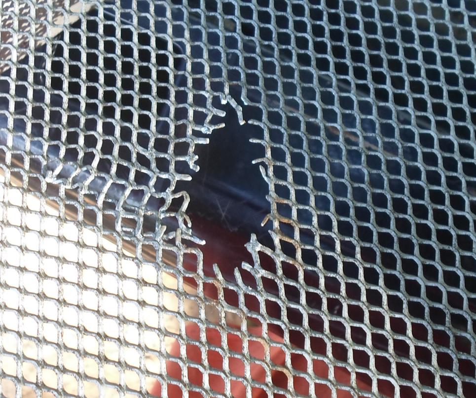

Tinkered a bit with a hammer and dolly: Mesh is very easy to work and got it much improved in only 30 minutes or so.Made a big difference just removing all the vines and small limbs that had grown thru various cracks.It will require some extra pop rivets and flattening in spots,but I don't believe I will have to remove any mesh to re-work it.I'm feeling much better about this dish already..as the pics will show.
Good_Panels.jpg These panels are almost good enough as is.Notice the dish would not break down into quarter section.Total of 10 segments.So 3 and 2 , 3 and 2.
Bad_Hole_Distant.jpg Bad_Hole.jpg The worst hole on the dish after working it our with hammer and dolly, and pliers.Distant and close focus.Will require some wire stitching.Had some type of small tree growing thru it.

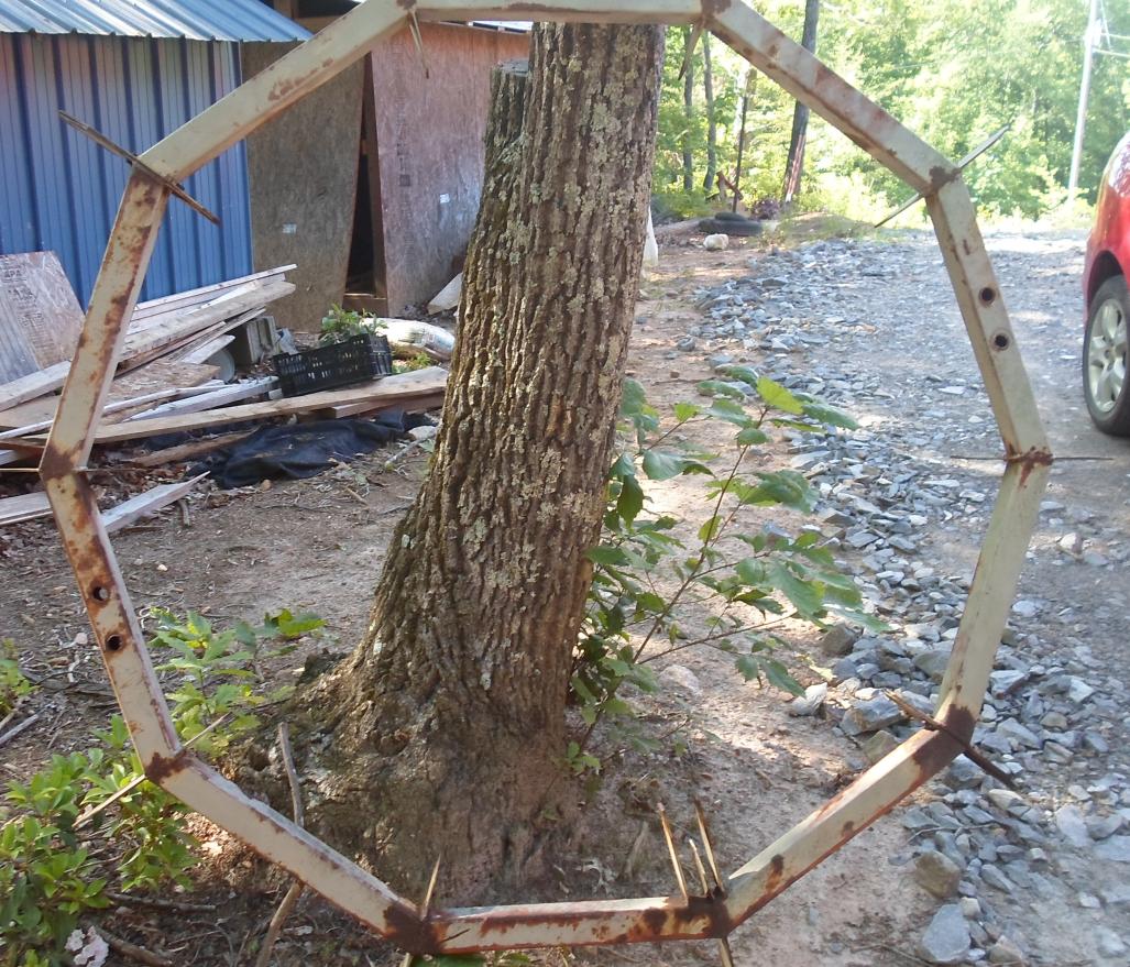

Mount_Ring.jpg Finally the mounting ring.This booger is 55 inches wide !

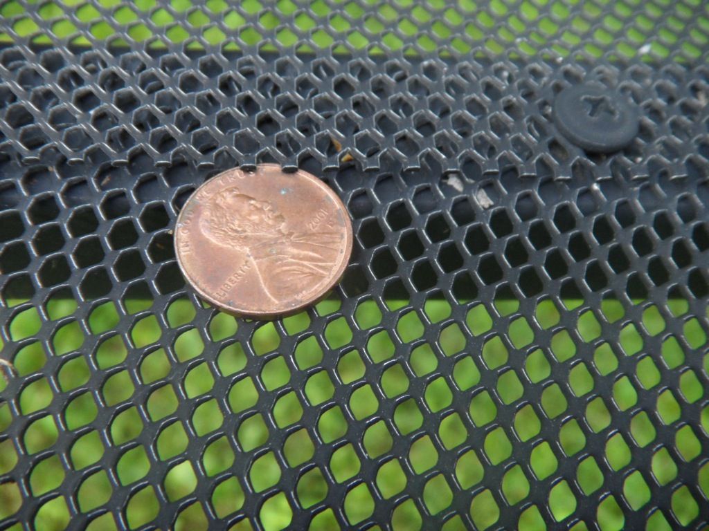

Tried to post this yesterday, maybe helpful...
Here's a photo of the panel overlap on a 'newer model' SAMI 10':
Looks like that Sami has 5 rows of holes in a penny width.Mine only has 3 rows...so holes are much larger on mine.I believe it will still suk down some serious C Band though.
