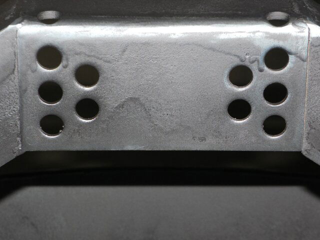

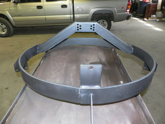

I've been working on my 10' transplant and reading about the AJAK mover. I found out the Winegard uses preset bolt holes where it attaches to the AJAK 180 to set the declination. But I've read two different explanations of the holes as to what they are set at. Either 1.0 degree interval or .5 degree interval. The manual claims there to be a chart attached to the mounting ring. But it's long gone if there was one. SO anyone seen this information? Or have this dish? Anole?

Since you have the ring on the ground, simply try a pair of holes and measure the angle. I have a Pinnacle with an Ajak motor and that's what I did. You could also just calculate it. I vaguely recall the holes are drilled for 0.5 degree steps, which would allow you to set the declination within 0.25 degrees. That's plenty close.

It's pretty obvious from your pictures, how the declination works.
You just haven't shown all the pieces.
As for how many degrees per hole, you could easily check that with an inclinometer.
I wouldn't be surprised if it's the 0.5° per hole, but is limited to a restricted range (not starting at zero)
Something like 4.5° to 6.5° would pretty much cover most of the contiguous United States.
That would be: 4.5°, 5°, 5.5°, 6°, 6.5°. - or five holes (which is just a guess)
If one degree steps, then...3.5° to 6.5 would go below Texas, and slightly into Canada.
So maybe: 3°, 4°, 5°, 6°, 7° - for the five steps (I might gamble on these numbers)

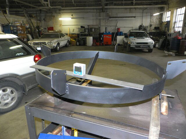

The one manual I read said 4°~8° . if so, the dish was set at 6° in the center hole. It was located at 45.4° latitude. Using the modified declination chart the declination from the old location to the new location would change 0.10° and probably not enough to make a change in the hole selected. Provided the dish was set correctly to start with. I think Pendragon is right and I will measure this for grins and giggles. I have a digital level and would be easy to do. I hope I can dial this dish in. If not I'll always be thinking I need finer adjustments here. But first I got to put it 15 feet up.
I measured the angles today and they were as the one manual I read said. 4,5,6,7,8 degrees "suitable for latitudes 20°~60°"

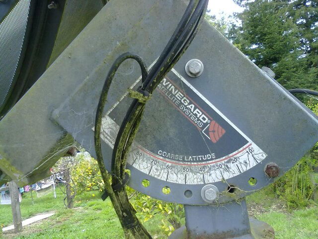

Recently acquired a 10' Pinnacle, tho not with the Ajak mount.
Here's a pic of the Winegard decal which may be of interest.
