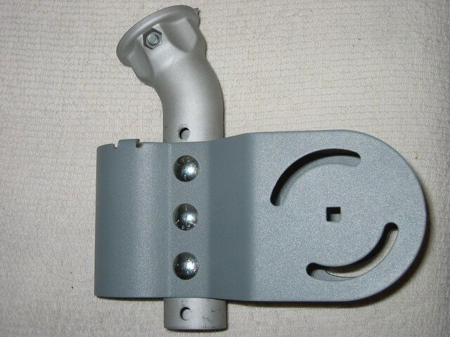

One more question. Please take a look at the photo. The Winegard antenna mount seems to be meant to sit at the very top of a pole with two metal tabs resting on top of the pole. However, the SG2100 intends for the antenna to "hang" underneath the motor. Have people been simply straightening the two metal tabs with players? Or is there some other trick to installing this dish on a motor?

I would just saw them off/ or bend them up, I would also drill a hole for a bolt right through the bracket and mounting tube (already there) or it may/will move in the wind.

From the looks of your picture, I only see two Tabs, which would lead me to believe that they are there so you don't go to high on that shaft. In other words, turn it over and slide it back on and the Tabs will stop it from being to far up.... but, that is only a guess ;)

Actually - the mount is meant to be put on top of a pole. The tabs would hold the entire assembly in place and prevent it from sliding down the pole. But when mounted on the 2100 motor - the "pole" gets inverted. One could put on the antenna mount upside down. But that would make getting the elevation angle more complicated...

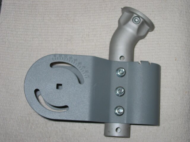

Just thought i would share on how i did my SG2100 + Winegard 1m dish. Is the same drilling idea from Here
but I drilled mine higher for better grip and support. IMO opinion this technic is stronger and more secured then the PCV deal.
