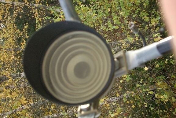

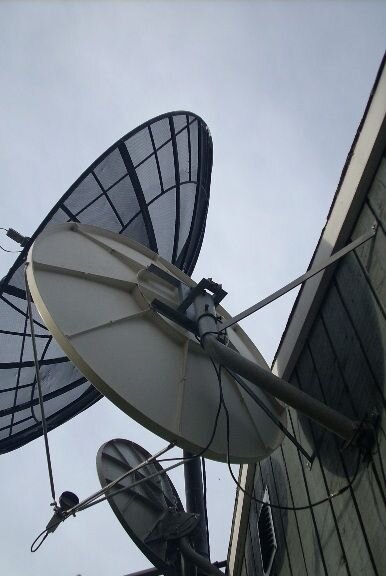

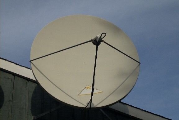

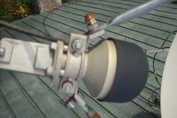

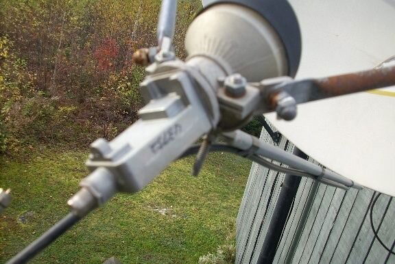

Thank you everyone for your responce, sorry it took two weekends to get the pictures up. My wife had me doing the honeydue list.
Anole, here's the pictures you where looking for. And Tron, does this look like a single-polarity LMB.
I appreciate your input.

But, what writing is on the LNB?
That might be helpful.
The logo on the dish is hard to read.
What does it say?
Meanwhile, I'll be salivating. :D
Its hard to tell about the LNB polarity. The feedhorn seems to be standard C-120, and it looks like there MIGHT be a waveguide in there between it and the LNB, which would indicate single polarity. Since most commercial dishes don't use voltage switching LNBs, I would say odds are it is a single polarity LNB.
I think you're right Cavsolutions, it looks like a Prodelin dish. Thanks for the info.
Anole, the only thing on the lnb is Norsat 7000A Series Module GM-6921 11.7-12.2 GHZ and a serial number. As far as the logo goes, it's so faded it's unreadable but I assume it's XM RADIO.
