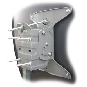

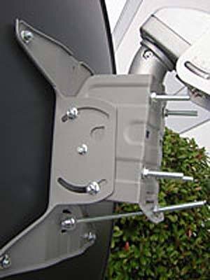

You might want to at least get the links from post #4 of this thread.
They have to do with a member modifying that very dish for easier vertical trimming.
Making the mod ahead of time, would be easier than retrofitting it.
And after looking at both Fortec and GeoSatPro 1.2's, I think I'd buy the latter,... if I couldn't find a PrimeStar somewhere.
Check pictures below of their mount.
And a kick in the shins to SatAv for not having these pictures and the PDF manual on his web site. :rolleyes:

I stand corrected
Well, when you're right, you -are- right! :eek:
Maybe it was the 90cm mount pix I was looking for...
Or maybe it was PDFs for all the dishes...
I remember trying to look up their 2.4 m dish, and not finding much on it, either.
I'm pretty sure if they sold a 1.8 m as nice as their 2.4 m, I'd have trouble resisting it. :)
Guess I should've checked my facts before flying off at the handle. :cool:
