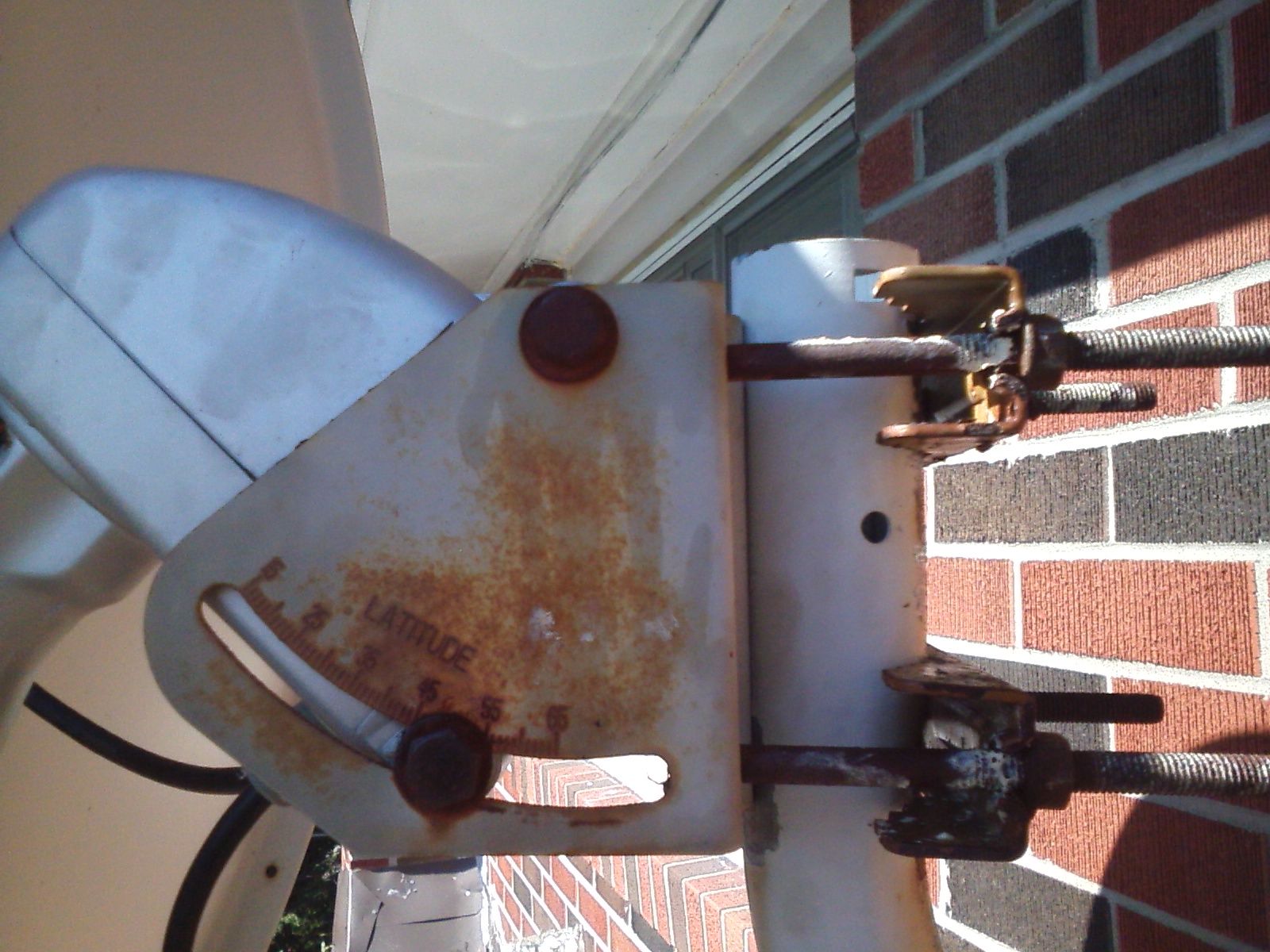

I've attached some photos of my re-adjustment. It took me two days to finally tweaked. I used 77W Echostar 8(79W for Toronto) DBS as my southern satellite and now I get full-strength on all sats including 30W which I couldn't get a good lock on, now I get tons. On sat 77W I got about 92% on a TP. But, now I am not able to pick up on those which I mentioned in the what's up there thread. Even if I skew the lnb. This was my primary reason to buy a Geo MicroHD for those feeds. I would like to elaborate fewer but, I don't want to divulge the identity of these channels. I am convinced that it is the dish that has distorted for the past 8 years.
BTW...on the SG2100 I left the angle the way it is. I remember years ago that the angle was a bit off if I used the chart in the instructions. Also, I've left the angle of the dish alone too. The purpose for the readjustment was the fact that the arms were not fully secured to the brick wall. That first time was to avoid making extra holes in the wall. Which didn't help much with the signal.
The post (with dish and motor) is now bang-on level, which was never like this before.
