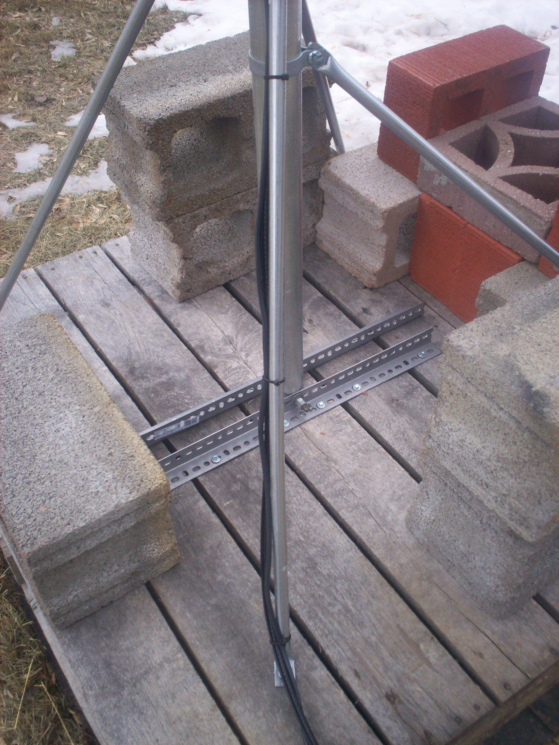

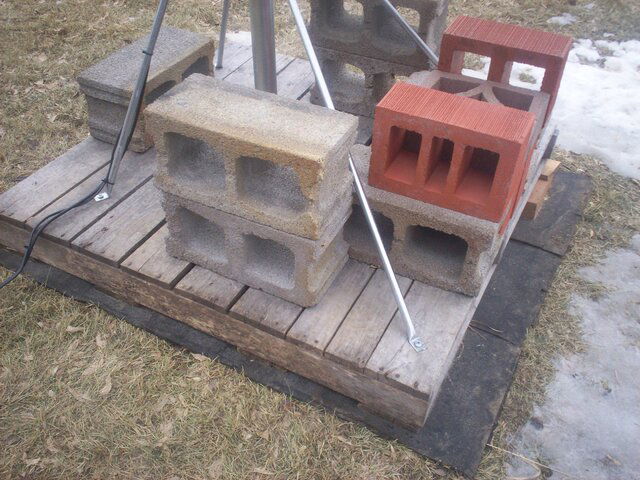

FWIW, this is how I set up a pallet for the 6' WSI.
First, I read the excellent threads on this site, took notes and scavenged for parts such as shingles and pallet.
The legs are 3/4" conduit pinched and bent in a vise.
Installation in November required scraping snow away to expose the ground. The first warm spell caused some settling and re-plumbing was necessary.
I set the mast off center of the pallet so that the brick ballast would be more effective leverage against the wind.
It is the 6' WSI dish and the information on this site that opened up the world of c-band for me.
BTW, I'm receiving from 55.5W to 139.0W but missing a lot of S2 signals.

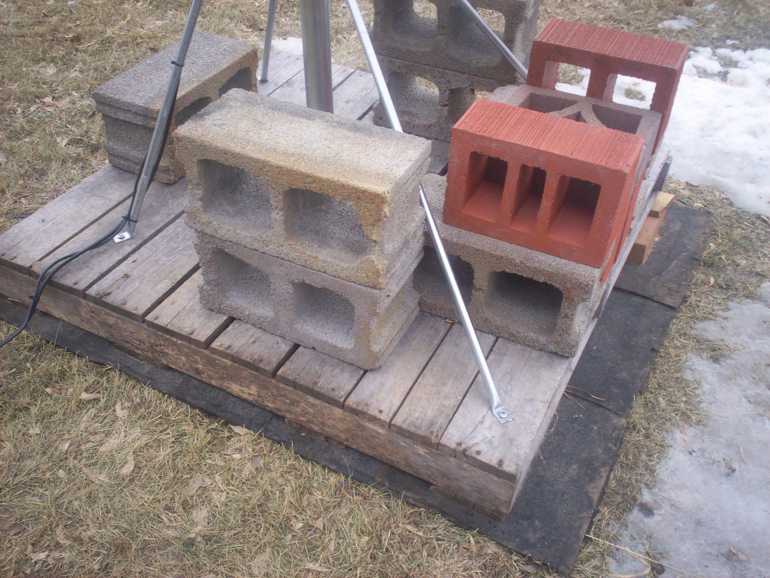

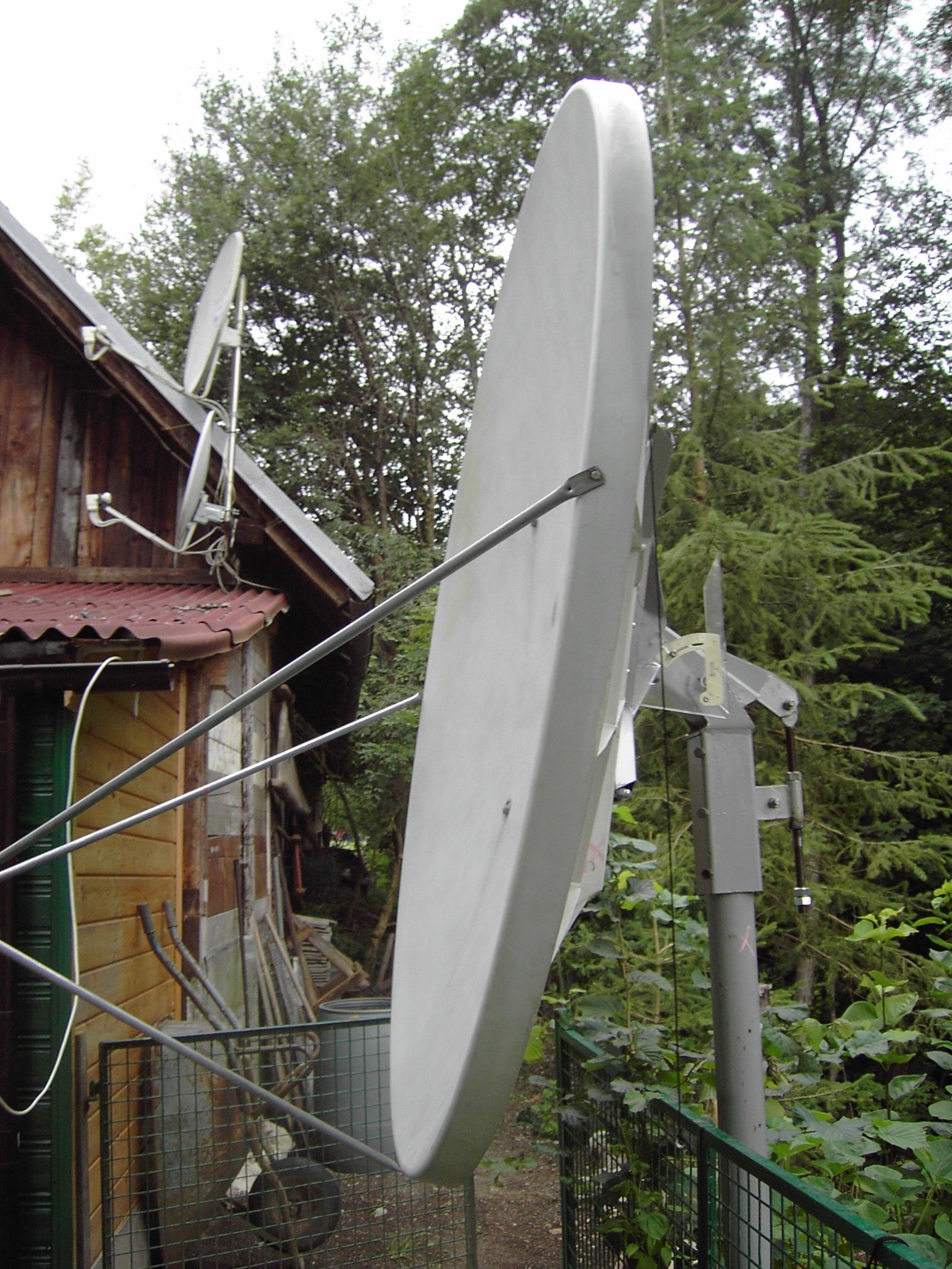

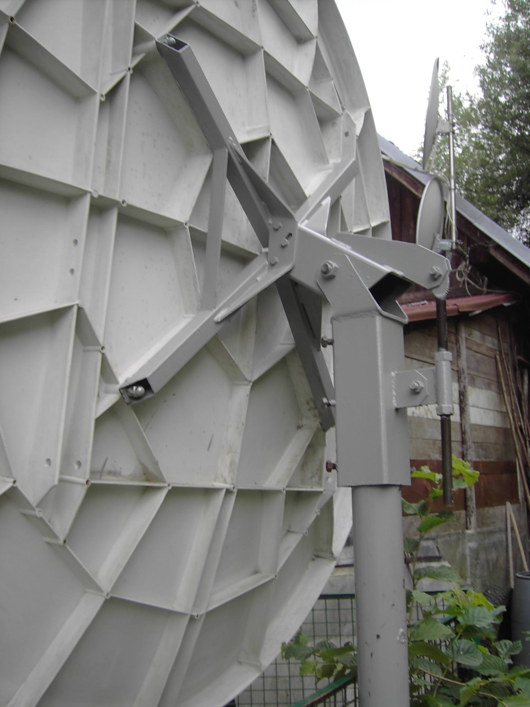

Hello The handyman, I like what you have made. I have a similar problem as you had. I have a Northern Satelite Corp NSC 18-1 dish 2.1 x 1.85 m. (probably 6' 6"x 6' 0" or so) Complete with stays, feed horn and dish mount.
Problem 1. I have attached 2 pics of my dish with the rotating mount, I would also like to convert it to a polar mount. I have copied your photo to see if i can figure it out but would appreciate some ideas from some of the big dish experts. I just cannot understand which 2 ways this changes angles. Is the bottom U channel fixed to the round pipe or does this rotate along a horizontal axis, as mine does? Or is all the turning motions taking place on the approx 45° axis ? After studying yours I think that is the most logic, if so the U channel is fixed to the pipe. I think I could utilize my dish mount with the 4 large bolts etc.
Problem 2. I do not know the manufacturers offset angle of the dish so I trien using a straight edge from top to bottom on the front side of the dish then using apiece of wood from the underside of the bottom rim to the feedhorn. This gave me an angle of 24° maybe someone could enlighten me if they have such a dish.

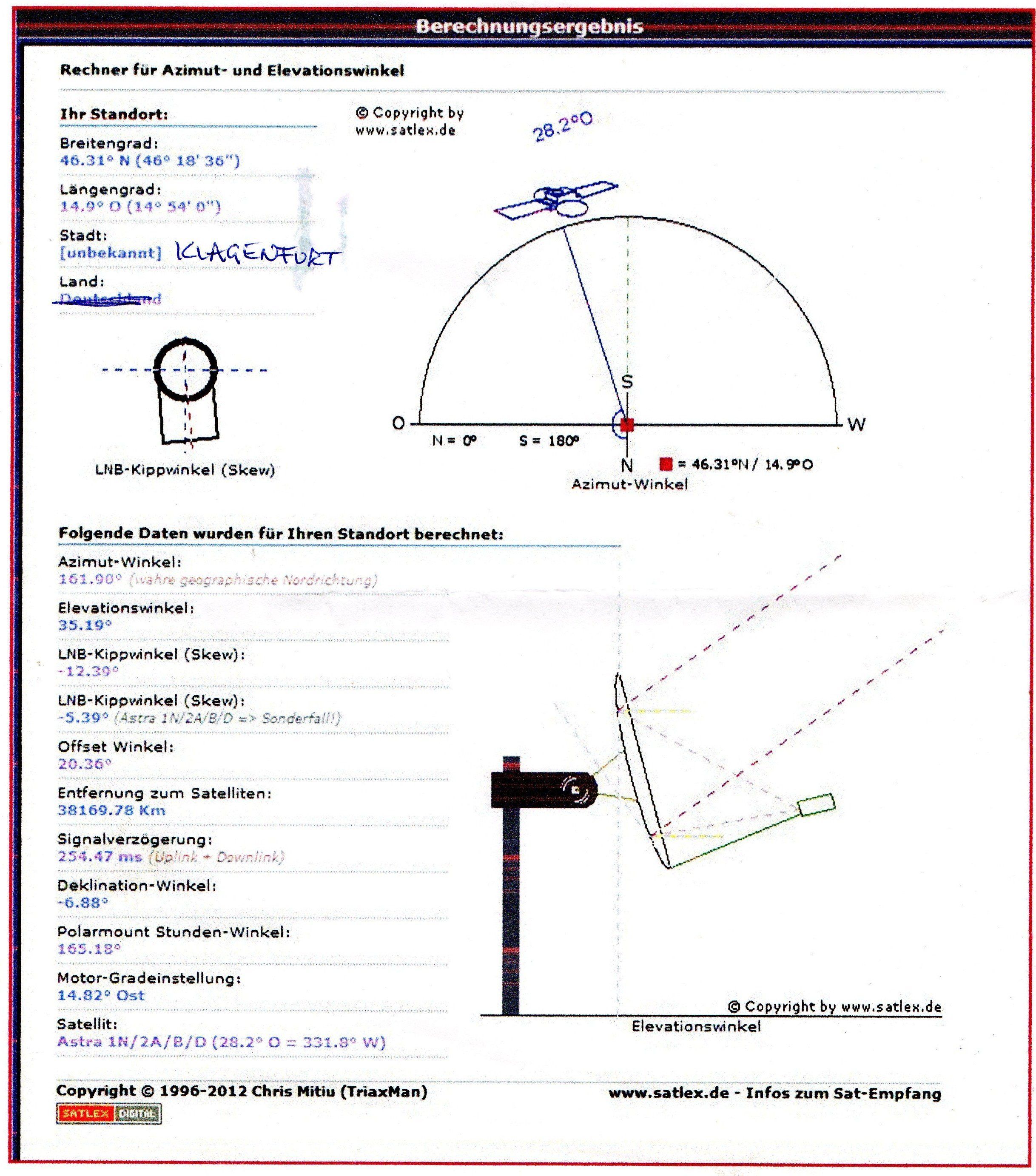

I have made an inclinometer and assume I have to add the dish's offset to the Offset angle of the Satelite which I am at 46°18'36"Nx 14°54'0"E Sat 28.2E which has a Elevations angle of 35.19°. These added together come to practically 60° making my dish very flat wereas I know it should be quite steep.

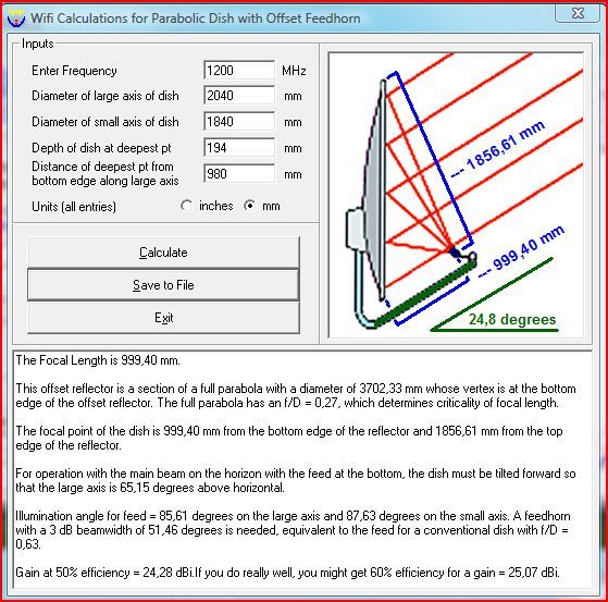

Thanks a lot, I have looked at the different links and downloaded the calc progs plus the seperate charts. I think to start with I will try to set my dish to one satellite probably Astra 2A/2D at 28.2E using my existing mount ( in the pic above) as it will take a bit of time to contruct the polar mount. At least I will know what the signal and the dish and LNB are working fine. I should also know what the offset angle of the dish is as well.
Using the parabolica calc programme using the wifi as you said I hope to at least achieve a signal.
When I find out the offset angle of the dish is this added to the elevation of the satellite in a northern hemisphere. My position is 46°18'36"N x 14°54'0"E
Also what Freq. should be entered in the wifi calculation? That is the first box to fill in. That is my first problem.
Thanks again for the tips.
I've just use a mid-band frequency. Usually just entered 12Ghz. (1200Mhz) seemed to work well calculating the offset of my 1.2's very closely. (don't think the frequency is used for calculating offset, just used in the 'gain' figure. BWDIK) (11.7 to 12.2 is the 'main' Ku band here)

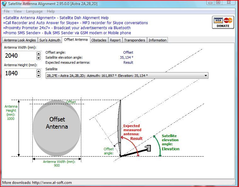

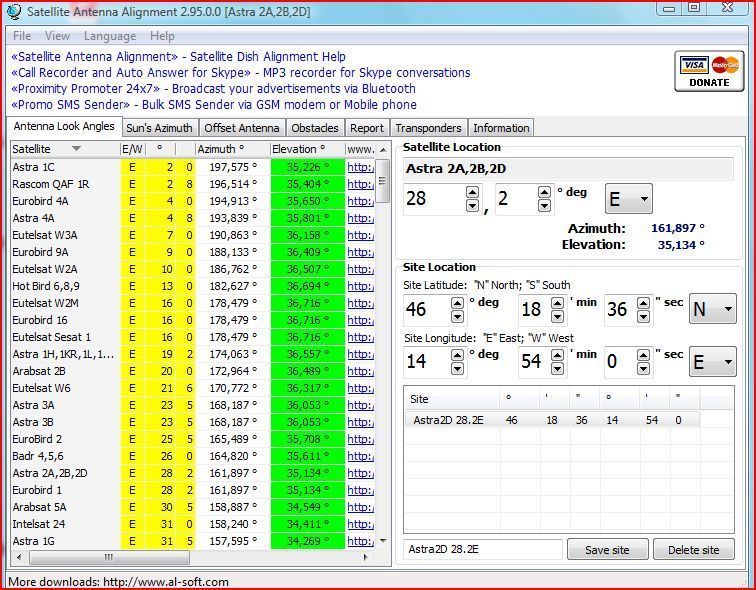

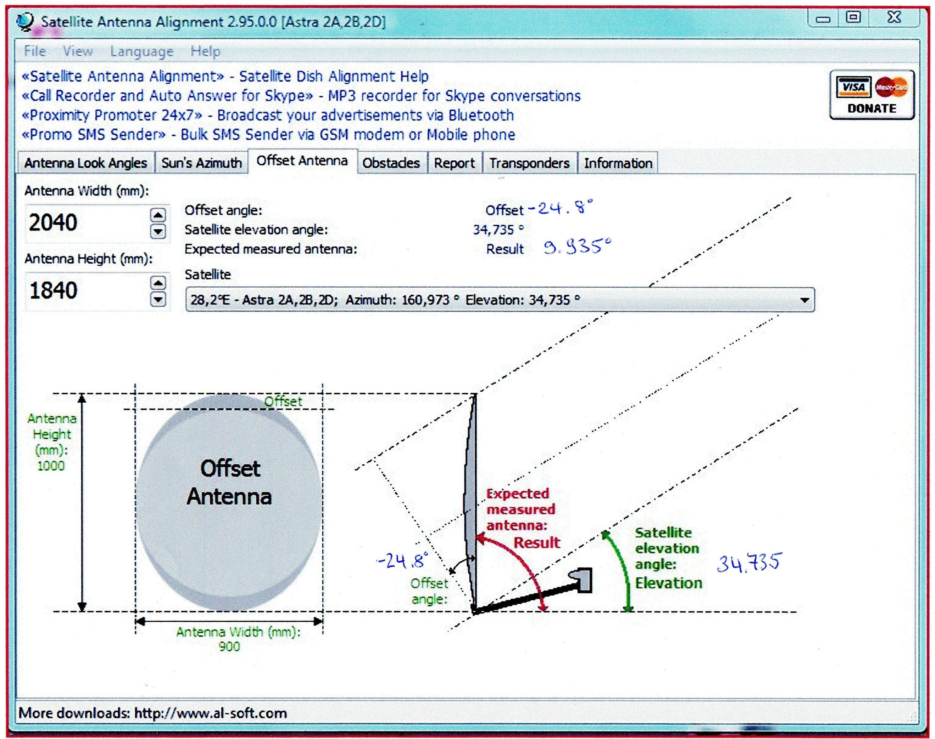

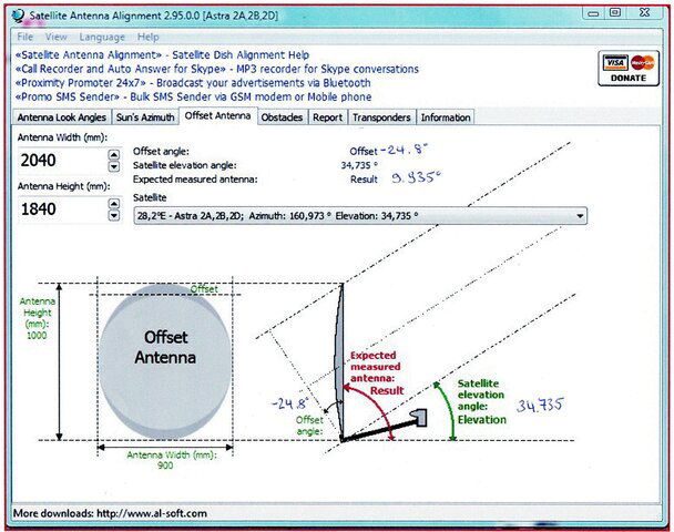

Hello again and thanks again. The calc tables obviously help the duffers like me who have forgotten all about geometry.
I have now hopefully calcuated my dish offset, also the elevation of astra 2D 28.2°E.
Attached a screen prints to help you think my thoughts on the outcome.
Having found the dish offset angle24.8° by cal, in the first screen print. Then the elevation of Astra 2D in the second screen print 35.134°. Do I add these together to get the angle the dish must be tilted from the vertical tilting backwards? this being 24.8 + 35.134 = 59.934°.
Looking at the third screen print does the sum of the 2 green angles equal the sum of the red angle? Or am I up the wrong street?
I started in this thread after seeing the polarmount setup by The handyone from 14th May 2012 as I want to change my mount which I assume is a fixed mount to a polarmount. I did want to see if I could get any other pics of his set.
Another thing the frequency doesnt come in the equasion as you said.

in the last pic, your dish dimensions are reversed.
dish face vertical (90°) dish 'looks' up 24.8°
Satellite is at 35.134°, 35.134 - 24.8 = 10.334
Dish face tilted back 10.334° from vertical. (79.666°)
Thanks again, Maybe I am making a little progress, its just that I put the angle the wrong way. Is it to do with N Hemisphere dish tilts back and Southern forewards, I cant quite grasp it. BUT as you put it which is the main thing the equasion is Sat Elv - Dish offset angle.
Now in my mind, tell me i am wrong but if I set the dish vertical and then tilt back 9.935° I should be up the correct tree.

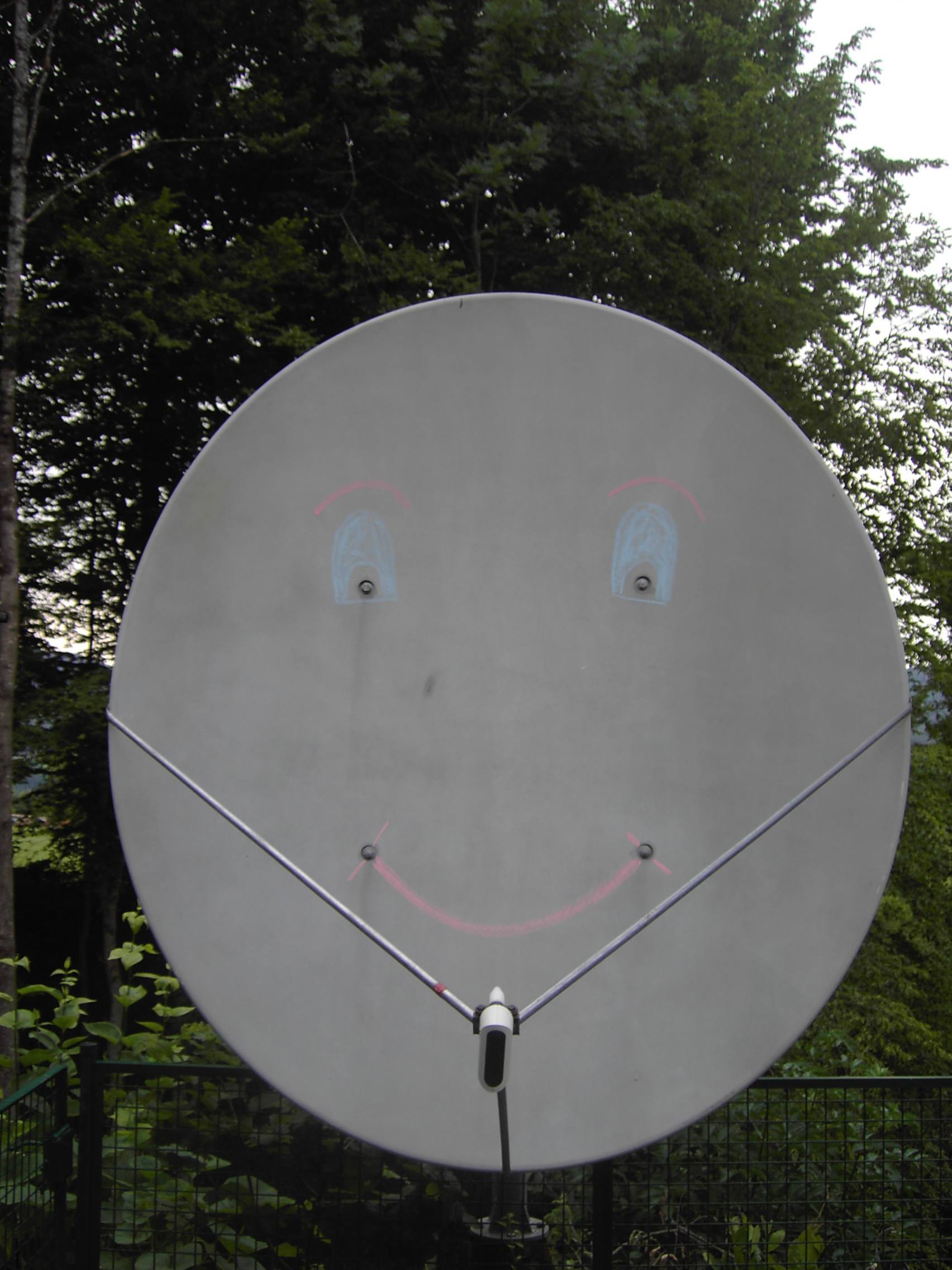

Incidently the 3 pics yesterday were using hyperthetical figures as there was a big thunderstorm here last night and raining cats and dogs, but this morning I entered by exact location which gave a slightly different Sat elevation. See pic.
Assuming figures are correct so I have the tilt corrrect, my next problem is setting the 28.2°.
With a big dish this is not that easy, I was thinking marking a line due south from the centre axis of my pole then another 28.2°, now does true north play its part or am I just using magnetic north? In which case it could be some 7° different as far as I can remember.
The small dish's I just turned a bit here or there but I imagine getting the buig dish set up must be very accurate.
Please comment.

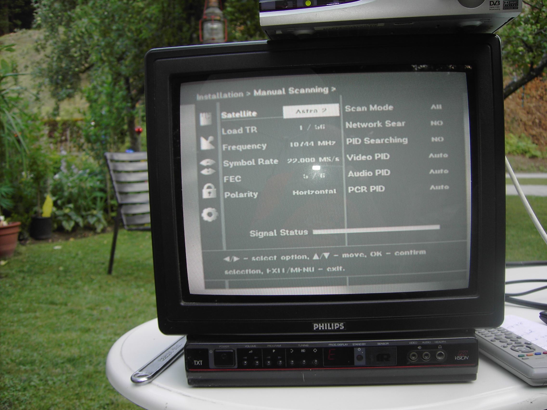

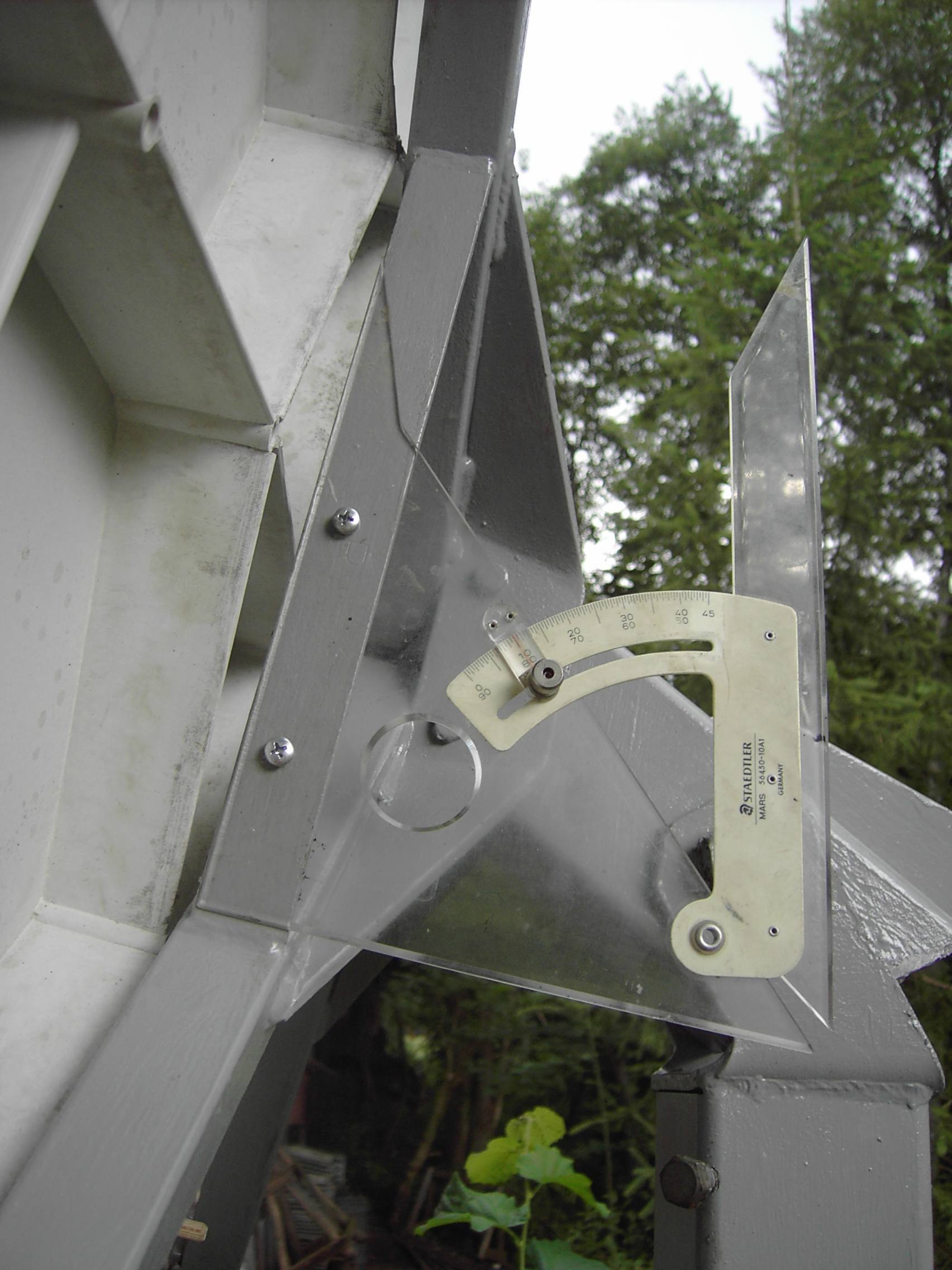

Hello again, I seem to have made some progress and wanted to add a postscript to my last thread.
To start with I set my dish to vertical, then added an inclonometer (an old Variable set square) I set the dish with the 9.9° tilt back, turned the dish approximatly to 28.2° and I had a wonderfull signal from the Astra 1D/2D.
One problem I tried a search for channels but maybe this old stb doesnt have the correct values. Maybe I can find them on my Spiderbox 9000Hd STB.
Have added the picks, the inclonometer worked well, I just used a spirit level on the vertical and it was correct without fiddling. Maybe someone else has a better idea but this is rustfree and easily readable with the scale.
