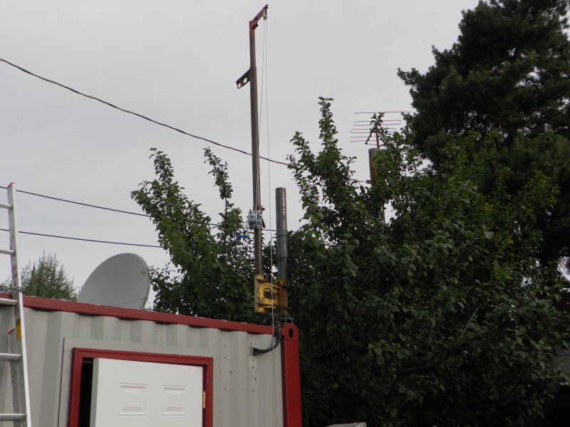

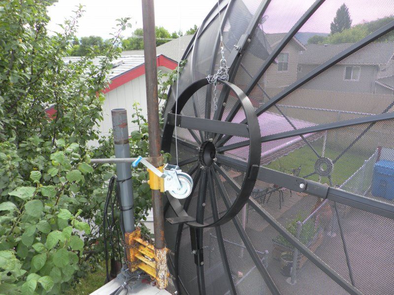

In the second picture, straight up from the pole, it looks like the screen near the edge of the panel may be pushed out a bit. It's easy to do when handling the panels and is easily corrected by rubbing your hand over the screen from the opposite side to smooth it out. You want the surface as uniform as possible. You should be able to see it in better light. It's a possibility that it may have just been the way the light was hitting it. You can take of that any time once you string the dish.
Just an observation. Things like that are hard to see in a photo. Installation looks great. You should be pleased when it's up and working. Great job! :whoo
