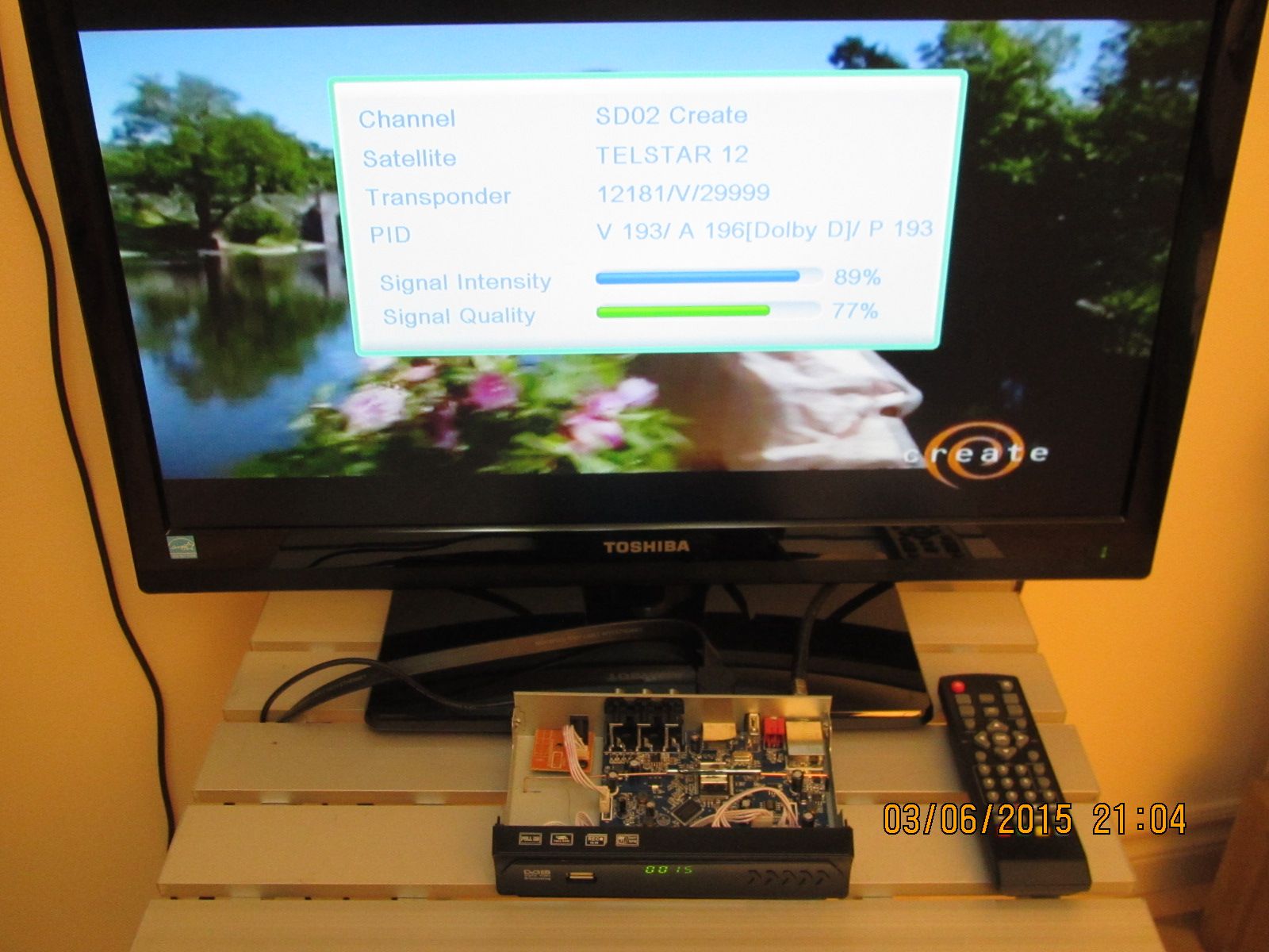

I just hooked up the first receiver which was described in first post. Heatsink temporarily attached, (still waiting for ordered glue).
