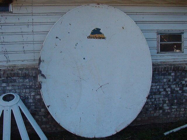

Hey everyone, Take a look at this. The often heard of never seen Model A0 2027 birdview off set spoon feed dish. I bought this 7 or 8 months ago. I had plans of cleaning it up and useing it. But now I realize I've got to many irons in the fire and ain't never gone'a get around to fixing it up. First off some facts about this dish. Unlike all other birdview dishes this one is not made of spunaluminum. This dish is made out of pressed steel. Much like the same material that the small dish or direct tv dishes are made out of. The back plate that the motor mounts on is a seperate piece that bolts on, not molded into the dish like on the aluminum dish. This dish is not without its dents and dinks. The guy I bought it off of his father bought it in 1984 and never installed it. So its spent it's entire life leaned up against a building. The reflector surface is fine except for about 5 small dents that looked like hail dents. I kinda fixed them but they need alittle more TLC . The reflector surface is slightly dented on the bottom were the feed horn support arms bolts on. The lip around the dish is bent in several places from the dish being rolled around and moved etc. The dish motor is a 37 to 1 gear ratio and still has the original read sensor. The LNB feed horn is an amazeing 15 inchs across. The dish is approx 8 ft 6in by 7ft 2in. If you have any questions are want any more pics just let me know. I would like to sell or trade this if possible so PM me if interested.

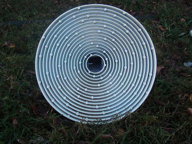

What's the diameter of the scalar plate?
I know it's pretty big on a regular Birdview.
edit: Oh! 15 inches? Wow, that's gigantic.
Wonder what they were thinking?
Didn't anyone know of conical scalars back then... or were they too hard to make?

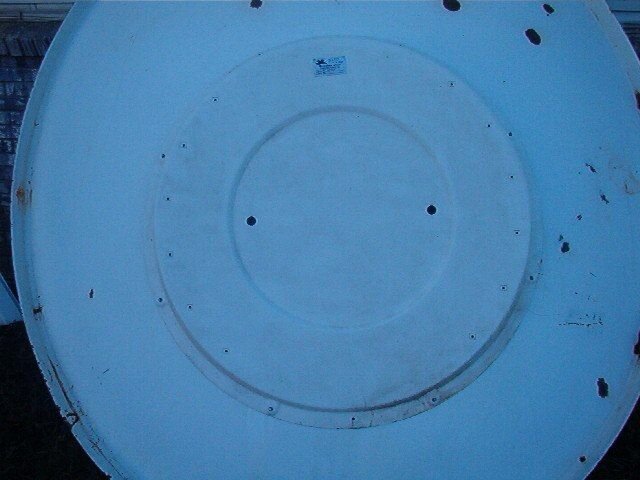

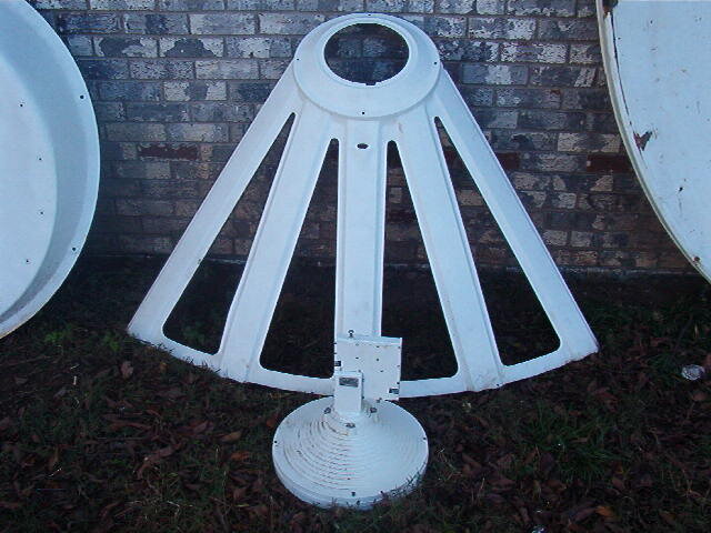

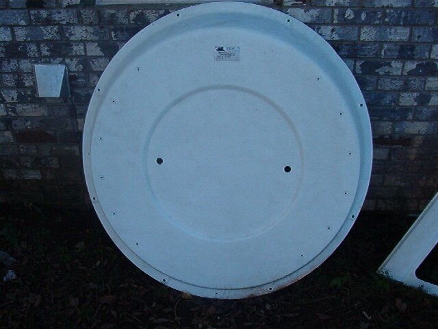

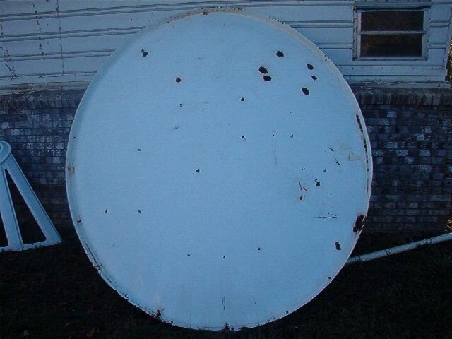

Someone correct me if the following is not true (picture numbers are the actual file names):
Picture #1 is the main 8' dish

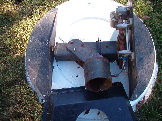

Picture #2 is the LNB mounting arm with scalar and LNB or preamp.

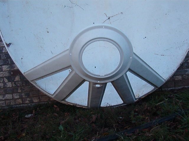

Picture #3 is the offset mount adapter that goes between the back of the dish and the black mount proper.
Its angle is probably the same as the dish's offset angle, permitting use of stock Birdview motorized mounts.
Picture #4 is lower edge of the dish with LNB mount in place.
Picture #5 the dish-side of the scalar.
Picture #6 is the LNB mount/holder, attached to the lower edge of the dish.
The offset adapter plate from photo #3, can be seen in the background.

Picture #8: I'm guessing this is a close-up of the offset adapter plate from photo #3?

Pic#7 is the backside of the birdview without the mount adapter in place.
Pic#8 is the backside of the birdview with the mount adapter inplace.
Pic#9 is the motor mount laying on the mount adapter as it would bolt on.

Ok Anole the focal lenght is 5ft 1 in. I am not sure how to figure the offset angle but if you tell me how to do it I will give it a try.
F/D and offset angle
Thanks for the measurement.
I say the F/D is: (where F= focal length and D= diameter)
5.083' divided by 7.166' width = 0.70

I tried to measure the offset of that washing tub that goes between the back of the dish and the black mount.
From your picture, I measured a very rough 15° but that's not very accurate because I didn't have a suitable angle in the picture.
Then, I tried to estimate the offset by measuring the face angle of the LNB holder (scalar mount, actually) to where I thought the center of the dish might be.
That appeared to be in the vicinity of 35°.
Again, not a very precise measure, due to not having the best picture.
If you could lay that tub down on a flat surface and measure the angle of the rim (or center, depending if you put it open side down or up, respectively), then that would be the better measure.
I'd expect it in the 20°..30° range, most likely.

The F/D was probably more interesting of the two, and it's right in the range you would expect.
Modern offset Ku-band LNBf's are in the 0.6 to 0.7 range, and should match that dish just fine.
To use a C-band LNBf, would probably require a conical scalar, as has been discussed so many times, here.
Exactly how the existing scalar works, and which band it's for, well, that's up for discussion. ;)
Linuxman has suggested the dish is for Ku, based on the hole in the middle of the scalar.
By my measure, the hole is 2.2". (plus or minus some error)
The opening of a B1stacked C-band LNBf is 2.4", so . . . .
. . . unless there's some advertizing literature saying the Spoon is Ku-only, I think it's fully C-band capable.
But, that's just an opinion. - :rolleyes:
edit: ... probably should measure the ring spacing and height on the scalar... that might suggest which band it's designed for...
